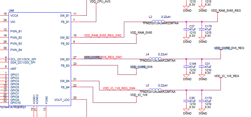

尊敬的 TI
我将使用 ti-processor-sdk-linux-j7200-evm-09_02_00_04
在 k3-j7200-sm-p0.dtsi 中、它将 LP8764-Q1 的 buck3 电压定义为 0.85V
  lp876441: pmic@4c {
    compatible = "ti,lp8764-q1";
    reg = <0x4c>;
    system-power-controller;
    interrupt-parent = <&wkup_gpio0>;
    interrupts = <84 IRQ_TYPE_EDGE_FALLING>;
    gpio-controller;
    #gpio-cells = <2>;
    buck1-supply = <&vsys_3v3>;
    buck2-supply = <&vsys_3v3>;
    buck3-supply = <&vsys_3v3>;
    buck4-supply = <&vsys_3v3>;
    regulators: regulators {
      buckb1: buck1 {
        regulator-name = "vdd_cpu_avs";
        regulator-min-microvolt = <600000>;
        regulator-max-microvolt = <900000>;
        regulator-always-on;
        regulator-boot-on;
      buckb2: buck2 {
        regulator-name = "vdd_ram_0v85";
        regulator-min-microvolt = <850000>;
        regulator-max-microvolt = <850000>;
        regulator-boot-on;
      buckb3: buck3 {
        regulator-name = "vdd_core_0v85";
        regulator-boot-on;

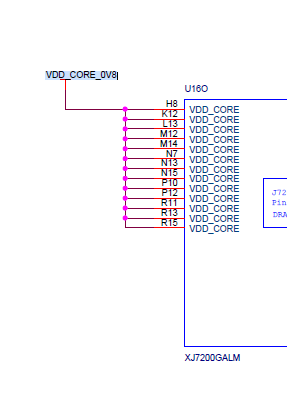

在参考原理图中、buck3 与 VDD_CORE_0V8 连接、如下所示
根据 DRA821U 数据表、VDD_CORE 的限制如下所示。
是否可以在器件树中将 buck3 电压更改为 0.8 以满足上表要求?
或者我应该使用原始值 (0.85) 吗?

    您好、Jace:
    [引述 userid=“606047" url="“ url="~“~/support/processors-group/processors/f/processors-forum/1589303/tda4vm-tda4vm-lp8764-buck3-voltage
    [/报价]
    可以在器件树中将电压设为 0.8V。
    - Keerthy
