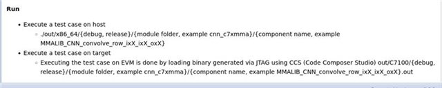

您好:
我尝试使用以下命令使用指南为 C7X 构建 mmalib 示例:
make -j12 TARGET_CPU=C7120 LINK_LIBS=1 cnn_c7xmma/MMALIB_CNN_convolve_row_ixX_ixX_oxX TEST_CASE=13 TEST_ENV=EVM CHECKPARAMS=1 SOC=J7ES TARGET_BUILD=release
但我得到了这个错误:
[C7X] Compiling C MMALIB_CNN_convolve_row_ixX_ixX_oxX_d.c
[C7X] Compiling C MMALIB_CNN_convolve_row_ixX_ixX_oxX_idat.c
Copying Prebuilt binary /home/amohame8/ti/ti-processor-sdk-rtos-j721s2-evm-11_02_00_06/mmalib_11_02_00_06/ti/mmalib/concerto/c7120/lnk.cmd to /home/amohame8/ti/ti-processor-sdk-rtos-j721s2-evm-11_02_00_06/mmalib_11_02_00_06/out/C7120/release/lnk.cmd
"/home/amohame8/ti/ti-processor-sdk-rtos-j721s2-evm-11_02_00_06/mmalib_11_02_00_06/ti/mmalib/src/cnn_c7xmma/MMALIB_CNN_convolve_row_ixX_ixX_oxX/MMALIB_CNN_convolve_row_ixX_ixX_oxX_d.c", line 849: warning #1219-D: arithmetic on pointer to void or function type
"/home/amohame8/ti/ti-processor-sdk-rtos-j721s2-evm-11_02_00_06/mmalib_11_02_00_06/ti/mmalib/src/cnn_c7xmma/MMALIB_CNN_convolve_row_ixX_ixX_oxX/MMALIB_CNN_convolve_row_ixX_ixX_oxX_d.c", line 850: warning #1219-D: arithmetic on pointer to void or function type
"/home/amohame8/ti/ti-processor-sdk-rtos-j721s2-evm-11_02_00_06/mmalib_11_02_00_06/ti/mmalib/src/cnn_c7xmma/MMALIB_CNN_convolve_row_ixX_ixX_oxX/MMALIB_CNN_convolve_row_ixX_ixX_oxX_d.c", line 887: warning #1219-D: arithmetic on pointer to void or function type
"/home/amohame8/ti/ti-processor-sdk-rtos-j721s2-evm-11_02_00_06/mmalib_11_02_00_06/ti/mmalib/src/cnn_c7xmma/MMALIB_CNN_convolve_row_ixX_ixX_oxX/MMALIB_CNN_convolve_row_ixX_ixX_oxX_d.c", line 888: warning #1219-D: arithmetic on pointer to void or function type
Linking /home/amohame8/ti/ti-processor-sdk-rtos-j721s2-evm-11_02_00_06/mmalib_11_02_00_06/out/C7120/release/cnn_c7xmma/MMALIB_CNN_convolve_row_ixX_ixX_oxX_C7120.out
<Linking>
"/home/amohame8/ti/ti-processor-sdk-rtos-j721s2-evm-11_02_00_06/mmalib_11_02_00_06/out/C7120/release/lnk.cmd", line 99: warning #19014-D:
   undefined preprocessor symbol 'j784s4'
"/home/amohame8/ti/ti-processor-sdk-rtos-j721s2-evm-11_02_00_06/mmalib_11_02_00_06/out/C7120/release/lnk.cmd", line 131: warning #19014-D:
 undefined                                              first referenced
  symbol                                                    in file
 MMA_CNNLIB_convolveBiasReLUCompute_ixX_ixX_oxX_perfEst /home/amohame8/ti/ti-processor-sdk-rtos-j721s2-evm-11_02_00_06/mmalib_11_02_00_06/out/C7120/release/module/cnn_c7xmma/MMALIB_CNN_convolve_row_ixX_ixX_oxX/cnn_c7xmma/MMALIB_CNN_convolve_row_ixX_ixX_oxX/MMALIB_CNN_convolve_row_ixX_ixX_oxX_d.obj
 ddr_size                                               /home/amohame8/ti/ti-processor-sdk-rtos-j721s2-evm-11_02_00_06/mmalib_11_02_00_06/out/C7120/release/module/cnn_c7xmma/MMALIB_CNN_convolve_row_ixX_ixX_oxX/cnn_c7xmma/MMALIB_CNN_convolve_row_ixX_ixX_oxX/MMALIB_CNN_convolve_row_ixX_ixX_oxX_d.obj
 msmc_size                                              /home/amohame8/ti/ti-processor-sdk-rtos-j721s2-evm-11_02_00_06/mmalib_11_02_00_06/out/C7120/release/module/cnn_c7xmma/MMALIB_CNN_convolve_row_ixX_ixX_oxX/cnn_c7xmma/MMALIB_CNN_convolve_row_ixX_ixX_oxX/MMALIB_CNN_convolve_row_ixX_ixX_oxX_d.obj
error #10234-D: unresolved symbols remain
error #10010: errors encountered during linking;
   0.out" not built
>> Compilation failure
make: [concerto/finale.mak:134: /home/amohame8/ti/ti-processor-sdk-rtos-j721s2-evm-11_02_00_06/mmalib_11_02_00_06/out/C7120/release/cnn_c7xmma/MMALIB_CNN_convolve_row_ixX_ixX_oxX_C7120.out] Error 1 (ignored)
RTOS SDK:11_02_00_06
MMALIB:11_02_00_06
    您好、
    我能够使用以下命令成功构建。 请尝试同样的方法。
    Ben Eapen Thomas
