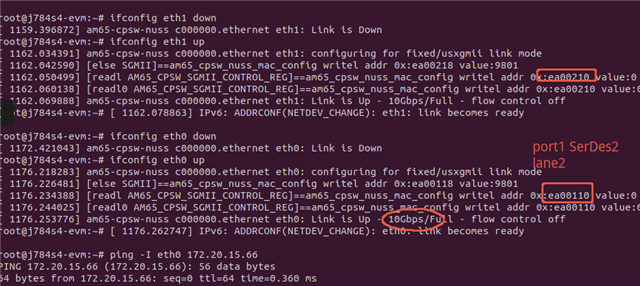

    你好、Tanmay
    1.当 assigned-clock-parents 设置为 "10" 而不是 "9"时、 ethtool 的输出 eth1 显示链路为 10Gbps:
    root@j784s4-evm:~# ethtool eth1
    Settings for eth1:
            Supported ports: [ MII ]
            Supported link modes:   10000baseCR/Full
            Supported pause frame use: Symmetric Receive-only
            Supports auto-negotiation: Yes
            Supported FEC modes: Not reported
            Advertised link modes:  10000baseCR/Full
            Advertised pause frame use: Symmetric
            Advertised auto-negotiation: Yes
            Advertised FEC modes: Not reported
            Link partner advertised link modes:  10000baseCR/Full
            Link partner advertised pause frame use: No
            Link partner advertised auto-negotiation: No
            Link partner advertised FEC modes: Not reported
            Speed: 10000Mb/s
            Duplex: Full
            Auto-negotiation: on
            Port: MII
            PHYAD: 0
            Transceiver: internal
            Supports Wake-on: d
            Wake-on: d
            Current message level: 0x000020f7 (8439)
                                   drv probe link ifdown ifup rx_err tx_err hw
            Link detected: yes
    但是、它不能 ping 通。

    USXGMII 连接成功(ping 使用以下 CPSW 配置):

    你(们)好
     我观察到一个相互矛盾的现象:虽然我可以在仅启用两个 USXGMII 端口 (MAIN_Cpsw0_port1 和 MAIN_Cpsw0_port2) 的情况下成功 ping 通、但用于串行器/解串器通道控制的 CTRL MMR 寄存器仍读回为 0。
    为什么即使寄存器读数为 0、我仍然可以成功 ping?

    Sudheer
    您好、
    从 CPSW SGMII 寄存器中、MAC 端口 4 已建立链路。
    您能否在下面添加 突出的更改并进行一次检查。
