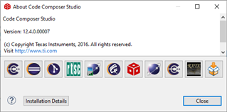

    CCS = 12.4.0.00007
    SDK = simplelink_cc13xx_cc26xx_sdk_7_41_00_17
