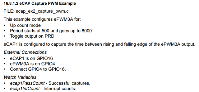

Part Number: TMS320F28379D
我按照ecap_ex2_capture_pwm例程进行ecap方波捕获实验,当我捕获例程中产生的epwm波时,捕获值都是正确的。但当我用信号发生器输入同频率、同幅度的方波时,捕获值变得不正确。我尝试增加gpio口的采样时间来进行改善,但是没有任何效果。
以下是我的代码:
// FILE: ecap_capture_pwm.c
// TITLE: Capture ePWM3.
//! \addtogroup driver_example_list
//! <h1>eCAP Capture PWM Example</h1>
//! This example configures ePWM3A for:
//! - Up count mode
//! - Period starts at 500 and goes up to 8000
//! - Toggle output on PRD
//! eCAP1 is configured to capture the time between rising
//! and falling edge of the ePWM3A output.
//! \b External \b Connections \n
//! - eCAP1 is on GPIO16
//! - ePWM3A is on GPIO4
//! - Connect GPIO4 to GPIO16.
//! \b Watch \b Variables \n
//! - \b ecap1PassCount - Successful captures.
//! - \b ecap1IntCount - Interrupt counts.
