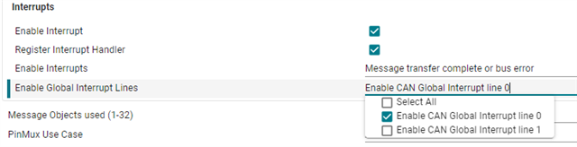

1. I just use CAN line 0 interrupt, why must I set both CAN interrupt 0 and CAN interrupt 1?

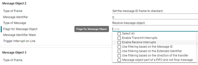

2. What do the options of Flags for Message Object mean? (Enable Transmit interrupts, use filtering base on the Message ID ...)

  • 1. I just use CAN line 0 interrupt, why must I set both CAN interrupt 0 and CAN interrupt 1?
    No, you don't have to enable both interrupt lines. You can select either line 0 or line 1 or both from sysconfig.
    Those parameters are used to set the bit fields of the following config registers:
    1. IFx Mask Register:
    2. IFx ID register:
    3. and IFx message control register:
