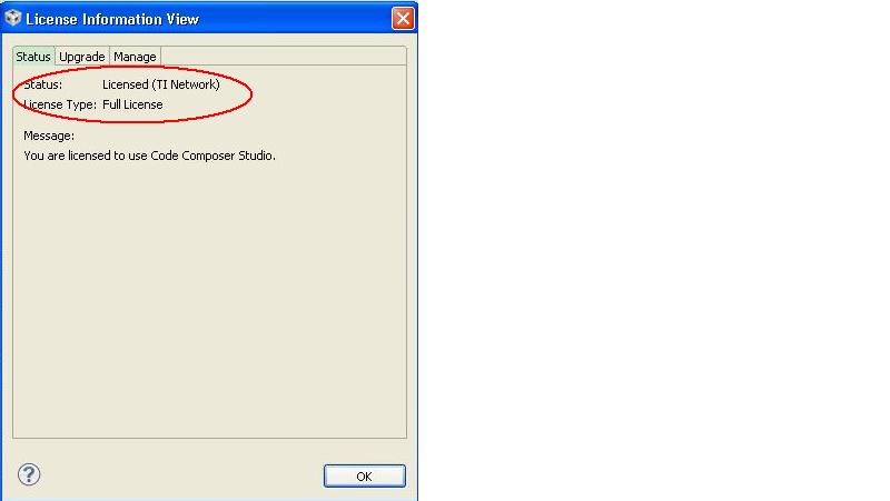

Hello ,I think I need your help desperately . I used the version of ccs4.2.4 to fininsh my task. when I try to connect to the target board(TMS320F28335),it pop up a message that the ccs4.2.4 is not licensed,but I have use the free license.

The free license can only have 90 days availability.
You need to purchase the license after 90 days.
but when I did not use the target board (TMS320F20335),It is licensed. why ? I am gratefui for your answers.

Could you please just capture screenshots for both cases?
The contents should include information like below by clicking Help --> Code Composer Studio Licensing Information.
Basically, it's recommend to simply load your license file when the dialog box is poped, also you can find license relevant info from http://processors.wiki.ti.com/index.php/Licensing_-_CCS
