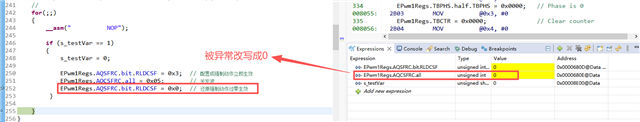

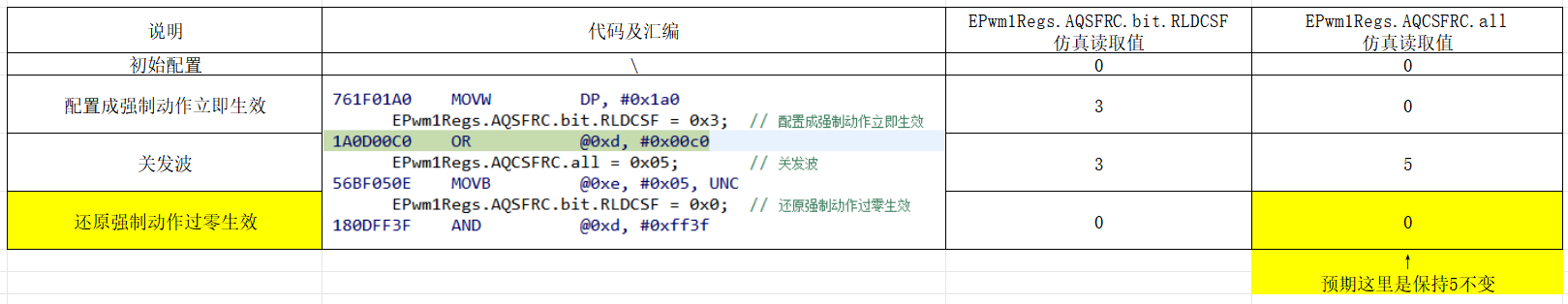

异常描述如下:当芯片处于开发波状态时,按“配置成强制动作立即生效” + “关发波” + “还原强制动作过零生效”的顺序执行后发波无法按预期的关闭。

  • 实际能看到发波被拉低的,表现就是预期要是发波关闭的关了后下个过零点自动恢复了。我现在的需求是:希望贵司能按我提供的步骤复现(就3句代码很容易测试),确认我所述的问题是否真实存在。

  • 我用路径 \ti\c2000\C2000Ware_5_02_00_00\device_support\f2803x\examples\c28\epwm_updown_aq  下的例程加入了测试代码,试了是可以复现的。我没看到有插入压缩附件的地方,测试的代码也很少,你可以自己在例程文件里添加测试代码来进行测试。
    for(;;)
        __asm(" NOP");
        if (s_testVar == 1)
            s_testVar = 0;
            EPwm1Regs.AQSFRC.bit.RLDCSF = 0x3; // 配置成强制动作立即生效
            EPwm1Regs.AQCSFRC.all = 0x05; // 关发波
            EPwm1Regs.AQSFRC.bit.RLDCSF = 0x0; // 还原强制动作过零生效

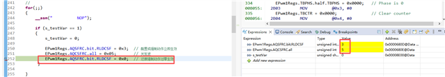

  • 你把你的测试数据发出来看下。我给你再提供下我测试的视频,视频里一开始展示了不打断点按 “配置成强制动作立即生效” + “关发波” + “还原强制动作过零生效”最终得到的还是发波处于开启状态,视频最后展示了单步测试确认了在最后一步“还原强制动作过零生效”执行时把已经配置成5的EPwm1Regs.AQCSFRC.all异常还原成0了。

    I see the issue you're referring to now.
    This is due to the switching from shadow to immediate then back to shadow.
    When going from immediate back to shadow, the shadow registers have value of 0x0 and will reload this.
    To work around this, you will have to write again to the shadow registers after switching from immediate mode.
    Try the following sequence. Also please ensure the FREE_SOFT is set to 0x3 so the TBCTR does not stop counting even while CPU is halted.
