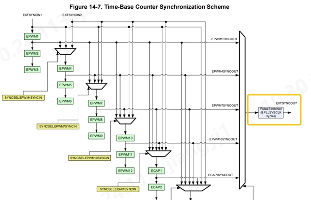

通过如下配置:
EALLOW;
CpuSysRegs.PCLKCR0.bit.TBCLKSYNC = 0; // Turn off the EPWM clock
SyncSocRegs.SYNCSELECT.bit.EPWM4SYNCIN = 0; //00: EPWM1SYNCOUT selected
SyncSocRegs.SYNCSELECT.bit.EPWM7SYNCIN = 0; //00: EPWM1SYNCOUT selected
SyncSocRegs.SYNCSELECT.bit.EPWM10SYNCIN = 0;//00: EPWM1SYNCOUT selected
SyncSocRegs.SYNCSELECT.bit.SYNCOUT = 0;//EPWM1SYNCOUT selected
OutputXbarRegs.OUTPUT2MUX0TO15CFG.bit.MUX14 = 3;//EXTSYNCOUT
OutputXbarRegs.OUTPUT2MUXENABLE.bit.MUX14 = 1;//OUTPUTXBAR2
GpioCtrlRegs.GPBGMUX1.bit.GPIO37 = 0;  //
GpioCtrlRegs.GPBMUX1.bit.GPIO37  = 1; //OUTPUTXBAR2
EDIS;
将GPIO37映射到OUTPUTXBAR2上,将产生的载波同步信号传给另一个28377S芯片。
另一端28377S芯片通过INPUT XBAR 映射到外部同步信号上。我想问一下
GpioCtrlRegs.GPBQSEL1.bit.GPIO43 = 2;
InputXbarRegs.INPUT5SELECT = 43;        //EXTSYNCIN1
我想问一下通过GPIO37输入的载波同步信号是什么样的波形?是一个很小的窄脉冲?还是一个高频的占空比为50%的信号?
