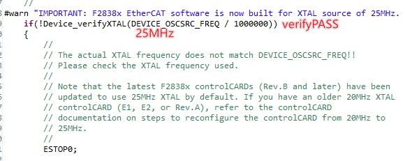

    I am conducting EtherCAT functional testing on custom hardware. I encountered the following issues:
  1.  I get PDI error in TwinCAT3
  2. verify  ECATPHYCLK failed
How can i close those issues?
The detailed description is as follows:
  1. my working environment:
    1.  custom hardware based on TMS320F28P650DK7
    2. C2000Ware5.0.0.0
    3. CCS 12.5.0.00007
    4. TwinCAT3 v3.1.4024.62 (Confirm that the network card and software configuration are good.)
  2. other information:
    1. TwinCAT3 can scan Box but some information incompletedSnipaste_2026-03-06_10-32-19.png
    2. get error EEPROM size and PDI type in TwinCAT3 Smart ViewSnipaste_2026-03-06_10-34-16.png
    3. cant write EEPROM use TwinCAT
    4. get PDI watchdog cnt in TwinCAT Memory viewSnipaste_2026-03-06_10-37-58.png
    7. verify ECATPHYCLK freq 100MHz failed, check ECATDIV is 2Snipaste_2026-03-06_10-42-38.pngSnipaste_2026-03-06_10-42-03.png
