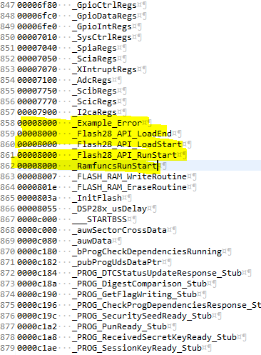

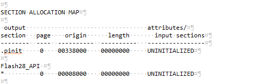

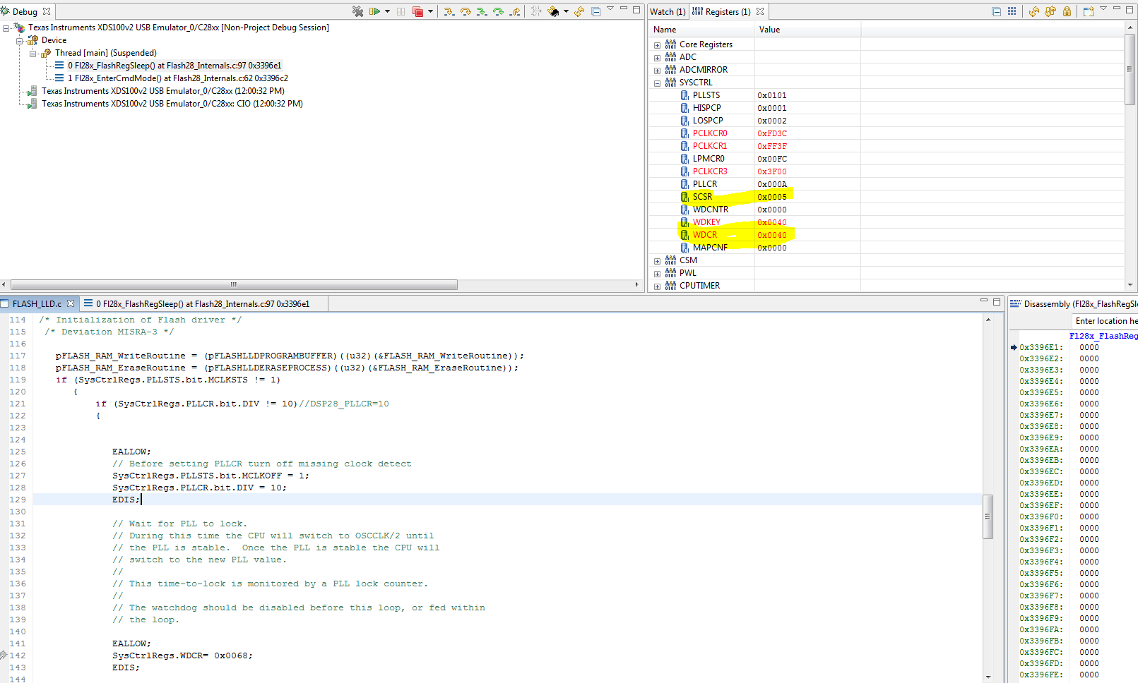

如图,TMS320F28235调用FLASH API 时,运行到check PLL ststus时停止,报Source not found.
调用flash之前用看门狗做过非中断方式的复位
不知道和这个问题有没有关系
Don’t execute any interrupt service routines (ISRs) that can occur during an erase, program or depletion recovery API function from the flash or OTP memory blocks. Until the API function completes and exits the flash and OTP are not available for program execution or data storage.
The watchdog timer is disabled.
见数据手册:C:\ti\controlSUITE\libs\utilities\flash_api\2833x\28335\v210\doc
controlSUITE_Flash2833x_API_Readme
