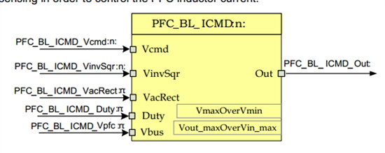

controlsuit中的库模块 PFC_BL_ICMD中的比例系数的意义
手册上这么说
PFC_BL_ICMD_VminOverVmax:n: is the ratio of minimum over
maximum AC input voltage the PFC stage is designed for represented in
Q24 format.
PFC_BL_ICMD_Vout_maxOverVin_max:n: is the ratio of
maximum output voltage over maximum AC input voltage and represented in
Q24 format.
Usage: This section explains how to use this module. The example assumes a PFC
Stage designed for input AC range of 280Vrms to 80Vrms and the max DC
bus voltage of 450V. Hence,
PFC_BL_ICMD_VmaxOverVmin:n: = _IQ24(280/80)=_IQ24(3.5)
PFC_BL_ICMD_Vout_maxOverVin_max:n: =
_IQ24(450/(1.414*280))=_IQ24(1.14)
问:
280Vrms to 80Vrms 是不是采集的AC电压的均方根的范围?
450是不是直流母线电压?

    只大概提到。这两个参数应该个比值。
    PFC_InvRmsSqr_VminOverVmax:n: is the ratio of minimum over
    maximum voltage, which in this example is 80Vrms/283Vrms. This ratio is
    then represented in Q30 format.
    The PFC_InvRmsSqr_Vmin:n: is thesame value represented in Q24 format
    PFC_InvRmsSqr_CLA宏如下
    #define PFC_InvRmsSqr_CLA_C(v)            \
     v.Out = (v.Vmin > v.In) ? v.Vmin : v.In;        \
     v.Out = __meinvf32(v.Out) * v.VminOverVmax;        \
     v.Out = v.Out * v.Out;             \
     v.Out = ((v.Out <  LIMIT_PFC_INVRMSSQR) ? v.Out : LIMIT_PFC_INVRMSSQR)
    v.Vmin 是一个比值,V.in是个电压输入,
     v.Out = (v.Vmin > v.In) ? v.Vmin : v.In;        一个电压  跟 一个比值 做比较,这一步是要怎样理解。
    能不能帮忙解释一下,谢谢!
