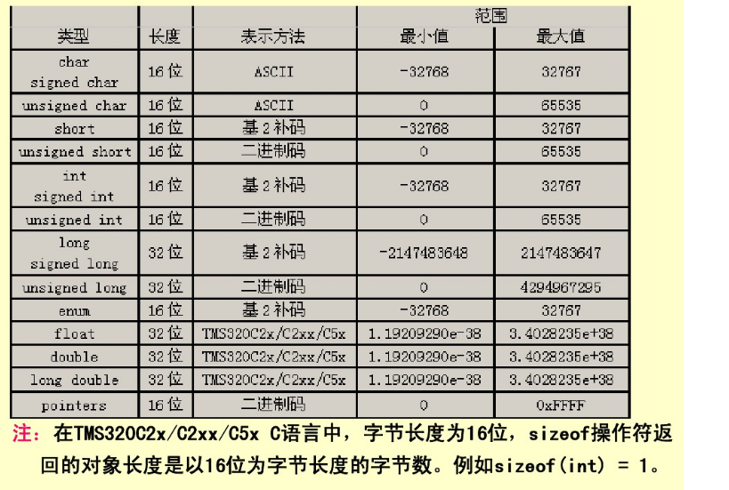

gpio操作对应寄存器地址分析
gpioBaseAddr = (Uint32 *)&GpioDataRegs;
        for (regOffset = 0; regOffset < sizeof(GpioDataRegs)/2; regOffset++)
            gpioBaseAddr[regOffset] = 0x00000000;
这段寄存器清零操作,没有看懂为什么要sizeof(GpioDataRegs)/2
对应寄存器地址,没对上,求大神讲解。

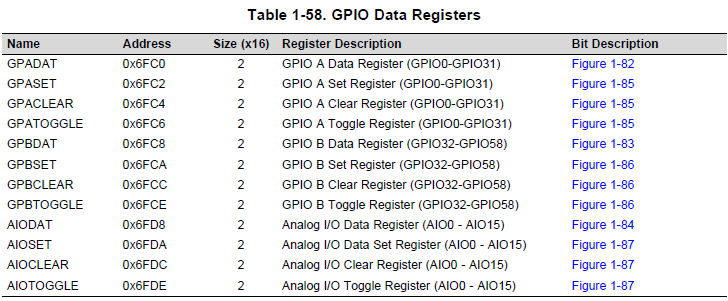

数据手册,寄存器地址,为什么寄存器地址都是偶数0 2 4。。增长,但是0h的寄存器,含有4个字节。
Offset Acronym Register Name Write Protection Section
0h GPADAT GPIO A Data Register (GPIO0 to 31) Go
2h GPASET GPIO A Data Set Register (GPIO0 to 31) Go
4h GPACLEAR GPIO A Data Clear Register (GPIO0 to 31) Go
6h GPATOGGLE GPIO A Data Toggle Register (GPIO0 to 31) Go
8h GPBDAT GPIO B Data Register (GPIO32 to 63) Go
Ah GPBSET GPIO B Data Set Register (GPIO32 to 63) Go
Ch GPBCLEAR GPIO B Data Clear Register (GPIO32 to 63) Go
Eh GPBTOGGLE GPIO B Data Toggle Register (GPIO32 to 63) Go
10h GPCDAT GPIO C Data Register (GPIO64 to 95)
