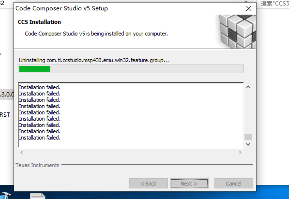

Win10 安装CCS v5.3 出现问题
Other Parts Discussed in Thread: CCSTUDIO
就是这样一直failed
error log如下:
!SESSION 2019-05-07 09:51:21.731 ----------------------------------------------- eclipse.buildId=I20120608-1200 java.version=1.6.0_13 java.vendor=Sun Microsystems Inc. BootLoader constants: OS=win32, ARCH=x86, WS=win32, NL=zh_CN Framework arguments: -application com.ti.common.core.initialize -rtsc.productDiscoveryPath C:/ti/xdctools_3_24_05_48;C:/ti/grace_2_00_01_65 Command-line arguments: -os win32 -ws win32 -arch x86 -application com.ti.common.core.initialize -rtsc.productDiscoveryPath C:/ti/xdctools_3_24_05_48;C:/ti/grace_2_00_01_65 !ENTRY org.eclipse.osgi 4 0 2019-05-07 09:51:22.309 !MESSAGE Application error !STACK 1 java.lang.RuntimeException: Application "com.ti.common.core.initialize" could not be found in the registry. The applications available are: org.eclipse.ant.core.antRunner, org.eclipse.cdt.codan.core.application, org.eclipse.cdt.core.GeneratePDOM, org.eclipse.cdt.managedbuilder.core.headlessbuild, org.eclipse.equinox.app.error, org.eclipse.equinox.p2.director, org.eclipse.equinox.p2.garbagecollector.application, org.eclipse.equinox.p2.publisher.InstallPublisher, org.eclipse.equinox.p2.publisher.EclipseGenerator, org.eclipse.equinox.p2.publisher.ProductPublisher, org.eclipse.equinox.p2.publisher.FeaturesAndBundlesPublisher, org.eclipse.equinox.p2.reconciler.application, org.eclipse.equinox.p2.repository.repo2runnable, org.eclipse.equinox.p2.repository.metadataverifier, org.eclipse.equinox.p2.artifact.repository.mirrorApplication, org.eclipse.equinox.p2.metadata.repository.mirrorApplication, org.eclipse.equinox.p2.updatesite.UpdateSitePublisher, org.eclipse.equinox.p2.publisher.UpdateSitePublisher, org.eclipse.equinox.p2.publisher.CategoryPublisher, org.eclipse.help.base.infocenterApplication, org.eclipse.help.base.helpApplication, org.eclipse.help.base.indexTool, org.eclipse.jdt.core.JavaCodeFormatter, org.eclipse.jdt.core.JavaIndexer, org.eclipse.ui.ide.workbench, org.eclipse.update.core.standaloneUpdate, org.eclipse.update.core.siteOptimizer, org.eclipse.wst.jsdt.core.JavaCodeFormatter, com.ti.ccstudio.p2app. at org.eclipse.equinox.internal.app.EclipseAppContainer.startDefaultApp(EclipseAppContainer.java:248) at org.eclipse.equinox.internal.app.MainApplicationLauncher.run(MainApplicationLauncher.java:29) at org.eclipse.core.runtime.internal.adaptor.EclipseAppLauncher.runApplication(EclipseAppLauncher.java:110) at org.eclipse.core.runtime.internal.adaptor.EclipseAppLauncher.start(EclipseAppLauncher.java:79) at org.eclipse.core.runtime.adaptor.EclipseStarter.run(EclipseStarter.java:353) at org.eclipse.core.runtime.adaptor.EclipseStarter.run(EclipseStarter.java:180) at sun.reflect.NativeMethodAccessorImpl.invoke0(Native Method) at sun.reflect.NativeMethodAccessorImpl.invoke(Unknown Source) at sun.reflect.DelegatingMethodAccessorImpl.invoke(Unknown Source) at java.lang.reflect.Method.invoke(Unknown Source) at org.eclipse.equinox.launcher.Main.invokeFramework(Main.java:629) at org.eclipse.equinox.launcher.Main.basicRun(Main.java:584) at org.eclipse.equinox.launcher.Main.run(Main.java:1438)
(杀毒已关)
  • 这个错误不太常见。应该和您的电脑本身的操作系统和设置有关。
    请您在其他电脑上尝试一下相同版本的CCS。另外建议您使用离线安装CCS
  • 分享之前客户成功安装的方法
    Enter Windows 10 Safe Mode
    * Windows Start -> <Shift> + Restart -> Troubleshoot -> Advanced Options -> Startup Settings -> Restart
    * Select option: Safe Mode with Networking
    * Start cmd as administrator
    * (Optional) Enter: net start msiserver
    * Run CCS offline installer
    * Allow the Windows Defender Firewall exception
    若是还不能成功安装,请您在 software-dl.ti.com/.../ccs_support.html 直接向CCS团队寻求帮助,祝您成功
  • 如果多次装不成功 建议换一个版本安装
