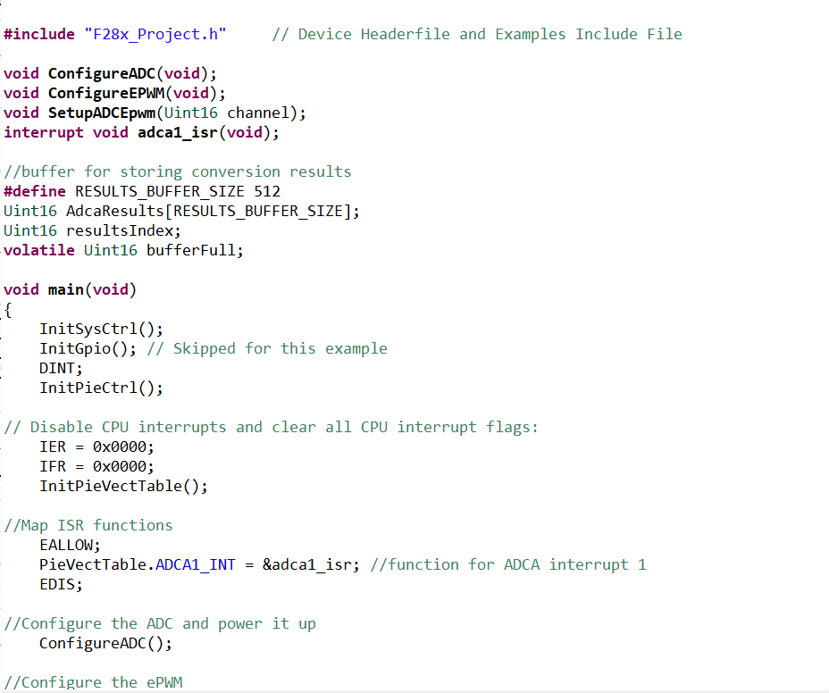

28377D芯片使用adcb应该怎么配置
在使用例程lab27_adc_soc_epwm的时候,想把adca修改成ADCb,结果进不了中断了,跪求大家帮忙看看是哪里配置出了问题,感激不尽。下面是我的代码配置。

#include "F28x_Project.h"     // Device Headerfile and Examples Include File
void ConfigureADC(void);
void ConfigureEPWM(void);
void SetupADCEpwm(Uint16 channel);
interrupt void adca1_isr(void);
//buffer for storing conversion results
#define RESULTS_BUFFER_SIZE 512
Uint16 AdcaResults[RESULTS_BUFFER_SIZE];
Uint16 resultsIndex;
volatile Uint16 bufferFull;
void main(void)
// Step 1. Initialize System Control:
// PLL, WatchDog, enable Peripheral Clocks
// This example function is found in the F2837xS_SysCtrl.c file.
    InitSysCtrl();
// Step 2. Initialize GPIO:
// This example function is found in the F2837xS_Gpio.c file and
// illustrates how to set the GPIO to it's default state.
    InitGpio(); // Skipped for this example
// Step 3. Clear all interrupts and initialize PIE vector table:
// Disable CPU interrupts
    DINT;
// Initialize the PIE control registers to their default state.
// The default state is all PIE interrupts disabled and flags
// are cleared.
// This function is found in the F2837xS_PieCtrl.c file.
    InitPieCtrl();
// Disable CPU interrupts and clear all CPU interrupt flags:
    IER = 0x0000;
    IFR = 0x0000;
// Initialize the PIE vector table with pointers to the shell Interrupt
// Service Routines (ISR).
// This will populate the entire table, even if the interrupt
// is not used in this example.  This is useful for debug purposes.
// The shell ISR routines are found in F2837xS_DefaultIsr.c.
// This function is found in F2837xS_PieVect.c.
    InitPieVectTable();
//Map ISR functions
    EALLOW;
    PieVectTable.ADCA1_INT = &adca1_isr; //function for ADCA interrupt 1
    EDIS;
//Configure the ADC and power it up
    ConfigureADC();
//Configure the ePWM
    ConfigureEPWM();
//Setup the ADC for ePWM triggered conversions on channel 0
    SetupADCEpwm(0);
//Enable global Interrupts and higher priority real-time debug events:
    IER |= M_INT1; //Enable group 1 interrupts
    EINT;  // Enable Global interrupt INTM
    ERTM;  // Enable Global realtime interrupt DBGM

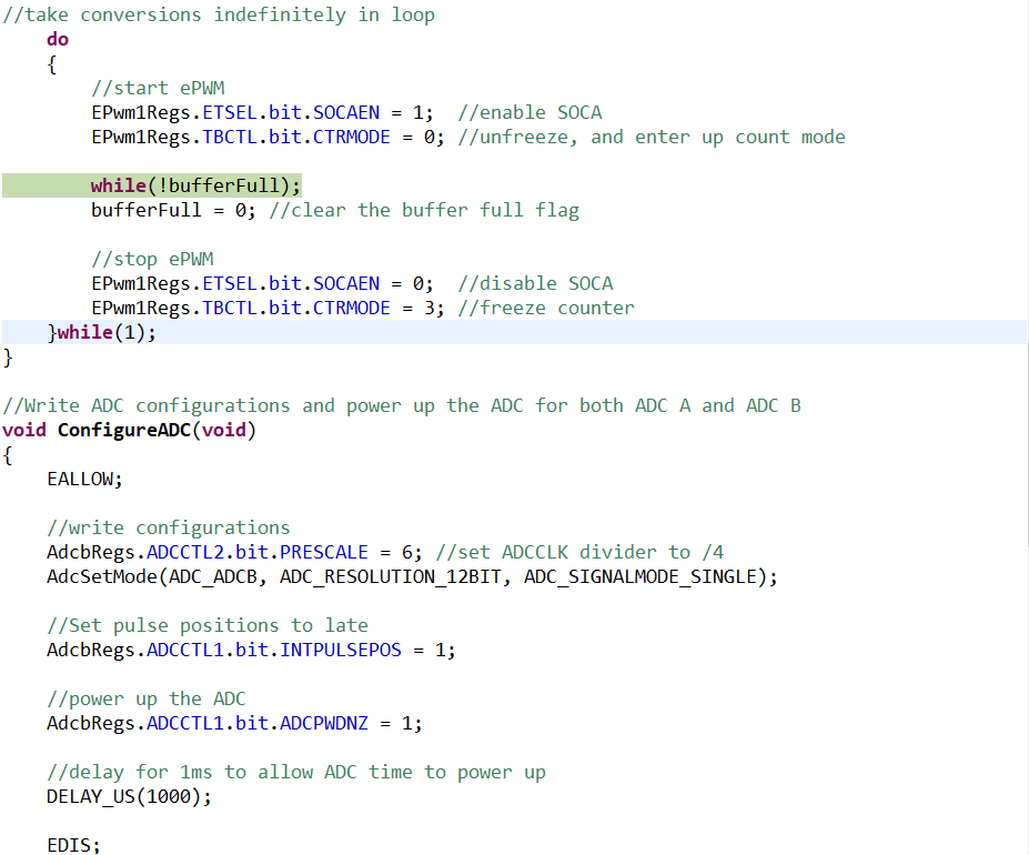

    do
    	//start ePWM
        EPwm1Regs.ETSEL.bit.SOCAEN = 1;  //enable SOCA
        EPwm1Regs.TBCTL.bit.CTRMODE = 0; //unfreeze, and enter up count mode
    	//wait while ePWM causes ADC conversions, which then cause interrupts,
    	//which fill the results buffer, eventually setting the bufferFull
    	//flag
    	while(!bufferFull);
    	bufferFull = 0; //clear the buffer full flag
    	//stop ePWM
        EPwm1Regs.ETSEL.bit.SOCAEN = 0;  //disable SOCA
        EPwm1Regs.TBCTL.bit.CTRMODE = 3; //freeze counter
    	//at this point, AdcaResults[] contains a sequence of conversions
    	//from the selected channel
    	//software breakpoint, hit run again to get updated conversions
    	//asm("   ESTOP0");
    }while(1);
//Write ADC configurations and power up the ADC for both ADC A and ADC B
	EALLOW;
	//write configurations
	AdcbRegs.ADCCTL2.bit.PRESCALE = 6; //set ADCCLK divider to /4
    AdcSetMode(ADC_ADCB, ADC_RESOLUTION_12BIT, ADC_SIGNALMODE_SINGLE);
	//Set pulse positions to late
	AdcbRegs.ADCCTL1.bit.INTPULSEPOS = 1;
	//power up the ADC
	AdcbRegs.ADCCTL1.bit.ADCPWDNZ = 1;
	//delay for 1ms to allow ADC time to power up
	DELAY_US(1000);
	EDIS;

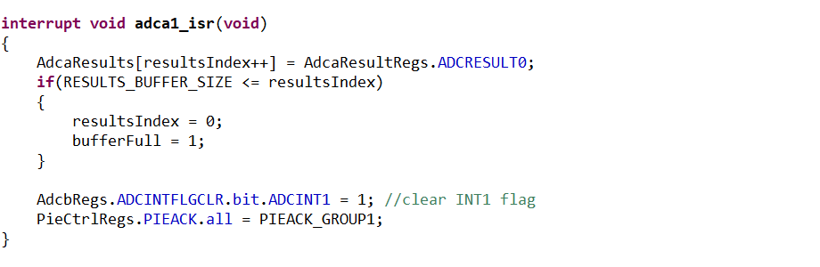

	AdcaResults[resultsIndex++] = AdcaResultRegs.ADCRESULT0;
	if(RESULTS_BUFFER_SIZE <= resultsIndex)
		resultsIndex = 0;
		bufferFull = 1;
	AdcbRegs.ADCINTFLGCLR.bit.ADCINT1 = 1; //clear INT1 flag
	PieCtrlRegs.PIEACK.all = PIEACK_GROUP1;
