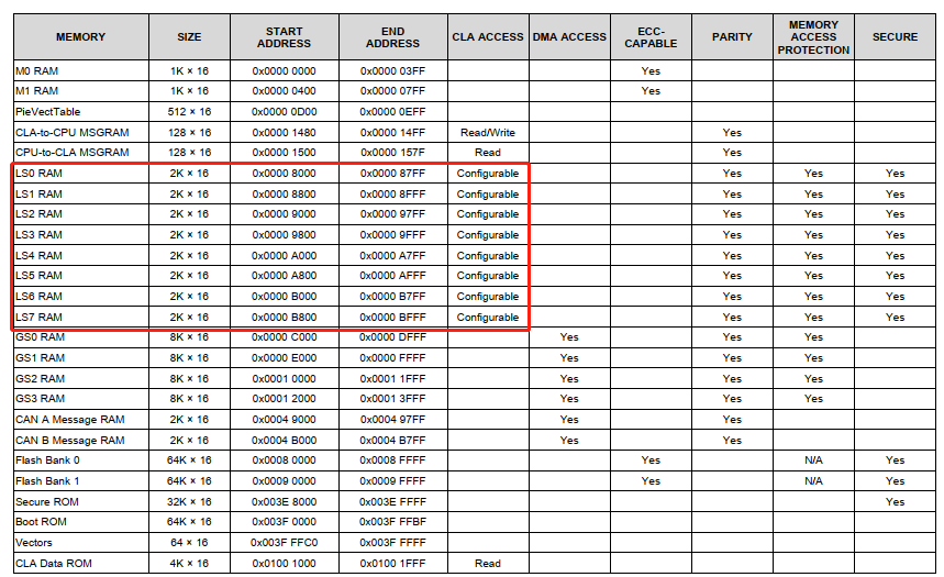

我在编译的时候出错,提示.text的section空间不够,提示空间需要0x453a,差不多17k空间,我看了280049的规格书中LS RAM总共才16k空间,不知道在我这种情况下,我应该怎么去分配text这个空间?
报错具体如下:
<a href="file:/D:/TI/ccs1011/ccs/tools/compiler/dmed/HTML/10099.html">#10099-D</a>  program will not fit into available memory, or the section contains a call site that requires a trampoline that can't be generated for this section. placement with alignment/blocking fails for section ".text" size 0x453a page 0.
规格书的存储空间如下:
  • 您可以在.text分配上合并LSRAM和 GSRAM

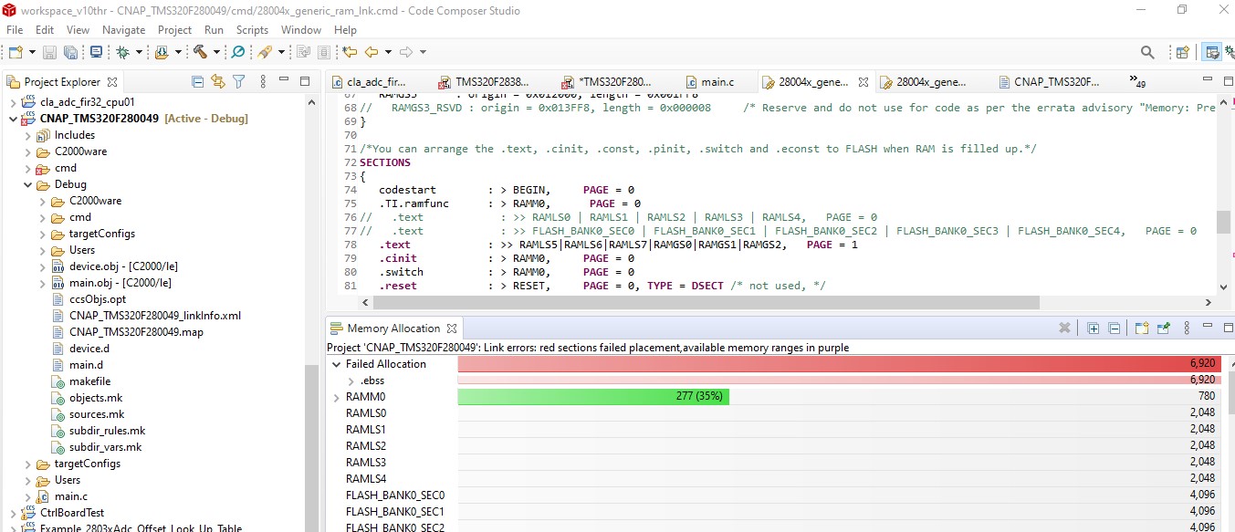

    还有一个问题就是,我尝试给.ebss分配了RAMLS的空间,在编译的时候提示空间需要0X1148,差不多4k,但是实际上我给他分配了16k,为啥还是会提示空间不够呢?
    配置代码为:
    .ebss : > RAMLS0 | RAMLS1 | RAMLS2 | RAMLS3 | RAMLS4 | RAMLS5 | RAMLS6 | RAMLS7, PAGE = 0
    报错描述为:
    <a href="file:/D:/TI/ccs1011/ccs/tools/compiler/dmed/HTML/10099.html">#10099-D</a> program will not fit into available memory, or the section contains a call site that requires a trampoline that can't be generated for this section. run placement with alignment/blocking fails for section ".ebss" size 0x1148page 0.
    这个是哪里出了问题了?

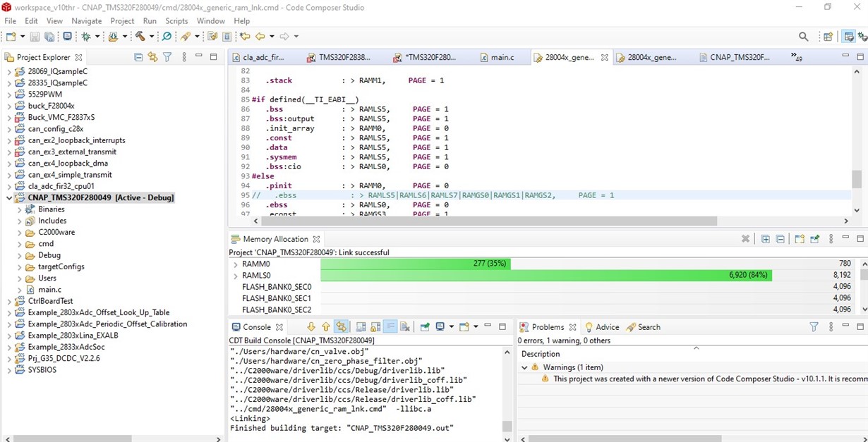

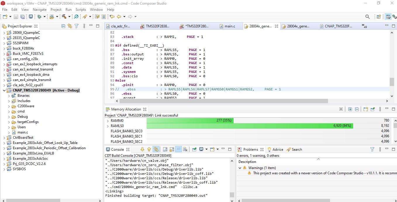

  • Hi Susan,我把.text的段分配到flash,然后再debug的时候,无法正常运行,提示错误为:
    Break at address "0x3fbd92" with no debug information available, or outside of program code.
    段配置如下:
    .text : >> FLASH_BANK0_SEC2 | FLASH_BANK0_SEC3 | FLASH_BANK0_SEC5, PAGE = 0, ALIGN(4)
    你也一起帮我看了,
    thanks!
  • 查看您的工程可以看到,您之前cmd的分配并没有成功
    而后我修改了一些,您可以看一下。编译后,就没有警告了

       codestart        : > BEGIN,     PAGE = 0
       .TI.ramfunc      : > RAMM0,      PAGE = 0
    //   .text            : >> RAMLS0 | RAMLS1 | RAMLS2 | RAMLS3 | RAMLS4,   PAGE = 0
    //   .text            : >> FLASH_BANK0_SEC0 | FLASH_BANK0_SEC1 | FLASH_BANK0_SEC2 | FLASH_BANK0_SEC3 | FLASH_BANK0_SEC4,   PAGE = 0
       .text            : >> RAMLS5|RAMLS6|RAMLS7|RAMGS0|RAMGS1|RAMGS2,   PAGE = 1

       .stack           : > RAMM1,     PAGE = 1
    #if defined(__TI_EABI__)
       .bss             : > RAMLS5,     PAGE = 1
       .bss:output      : > RAMLS5,     PAGE = 1
       .init_array      : > RAMM0,      PAGE = 0
       .const           : > RAMLS5,     PAGE = 1
       .data            : > RAMLS5,     PAGE = 1
       .sysmem          : > RAMLS5,     PAGE = 1
       .bss:cio         : > RAMLS0,     PAGE = 0
    #else
       .pinit           : > RAMM0,      PAGE = 0
    //   .ebss            : > RAMLS5|RAMLS6|RAMLS7|RAMGS0|RAMGS1|RAMGS2,     PAGE = 1
       .ebss            : > RAMLS0,     PAGE = 0
       .econst          : > RAMGS3,     PAGE = 1
       .esysmem         : > RAMGS3,     PAGE = 1
       .cio             : > RAMGS3,     PAGE = 1
    #endif
       ramgs0           : > RAMGS0,    PAGE = 1
       ramgs1           : > RAMGS1,    PAGE = 1
    // End of file.
  • Hi Susan,
    我看你就是把LS0 1 2 3 4 合并在一起了。我按照你的写法改,空间确实分配开了,也可以debug,但是为什么合并就可以,分开就不行呢?
