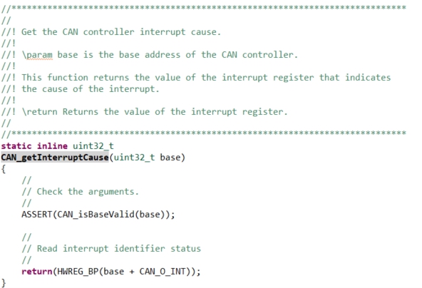

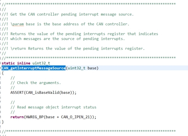

請問一下 CAN_getInterruptCause() 跟 CAN_getInterruptMessageSource()
兩者有甚麼差別??
CAN_getInterruptCause() 是說可以知道CAN中斷的原因,甚麼原因?
getInterruptMessageSource() 是說可以知道CAN中斷 interrupt message source.,message source是指CAN_L receive 的 訊息嗎?

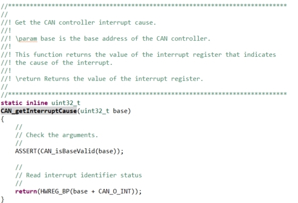

  • 你好,CAN_getInterruptCause() 应该是通过读取CAN中断状态以查找中断源,一般函数都会有介绍,如以下
    uint32_t status;
        // Read the CAN-B interrupt status (in the CAN_INT register) to find the
        // cause of the interrupt
        status = CAN_getInterruptCause(CANB_BASE);
        // If the cause is a controller status interrupt, then get the status.
        // During first iteration of every ISR execution, status = 0x8000,
        // which simply means CAN_ES != 0x07.
        if(status == CAN_INT_INT0ID_STATUS)
            // Read the controller status.  This will return a field of status
            // error bits that can indicate various errors.  Error processing
            // is not done in this example for simplicity.  Refer to the
            // API documentation for details about the error status bits.
            // The act of reading this status will clear the interrupt.
            status = CAN_getStatus(CANB_BASE);  // Return CAN_ES value.
            // Now status = 0x00000010, indicating RxOK.
            // Check to see if an error occurred.
            if(((status  & ~(CAN_STATUS_RXOK)) != CAN_STATUS_LEC_MSK) &&
               ((status  & ~(CAN_STATUS_RXOK)) != CAN_STATUS_LEC_NONE))
                // Set a flag to indicate some errors may have occurred.
                errorFlag = 1;
                glblStatus = status;
    方便给一下这两个函数的出处吗?
