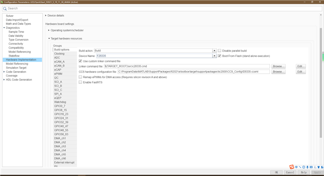

代码自动生成最后生成.out文件的时候在link时出现了 undefined preprocessor symbol 'BOOT_FROM_FLASH'
<Linking>
"C:/ProgramData/MATLAB/SupportPackages/R2021a/toolbox/target/supportpackages/tic2000/src/c28335.cmd",
line 16: warning: undefined preprocessor symbol 'BOOT_FROM_FLASH' "C:/ProgramData/MATLAB/SupportPackages/R2021a/toolbox/target/supportpackages/tic2000/src/c28335.cmd",
line 24: warning: undefined preprocessor symbol 'BOOT_FROM_FLASH' "C:/ProgramData/MATLAB/SupportPackages/R2021a/toolbox/target/supportpackages/tic2000/src/c28335.cmd",
line 32: warning: undefined preprocessor symbol 'BOOT_FROM_FLASH'
undefined first referenced symbol
in file --------- ---------------- _
main C:/ProgramData/MATLAB/SupportPackages/R2021a/3P.instrset/tic2000codegentools.instrset/ti-cgt-c2000_20.2.5.LTS/lib/rts2800_fpu32.lib<args_main.c.obj> _rt_OneStep c2833xSchedulerTimer0.obj error:
unresolved symbols remain error: errors encountered during linking;
"../LED.out" not built

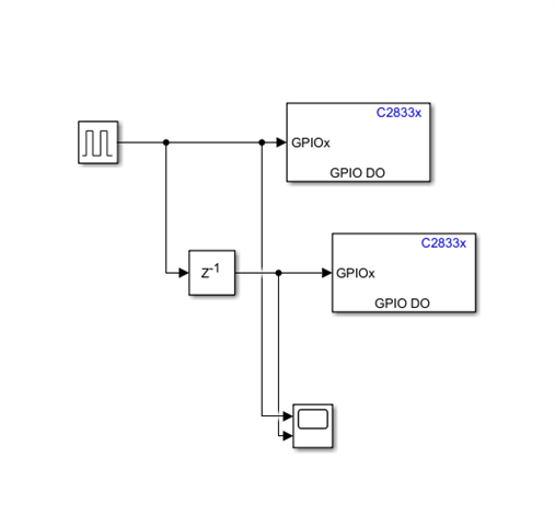

  • 能否请您详细说明下问题?您现在使用的是matlab以及TI例程?
  • matlab是2021a的  ccs是10.3的  模块是自己的

    是这个的问题吗
  • 看起来像是没有预定义BOOT_FROM_FLASH
  • 我感觉是这个问题ti-cgt-c2000_20.12.0.STS  但是我换了好几个还是提示BOOT_FROM_FLASH'
  • 抱歉,对matlab不太熟悉,但是根据错误提示的话,是您没有预定义BOOT_FROM_FLASH
