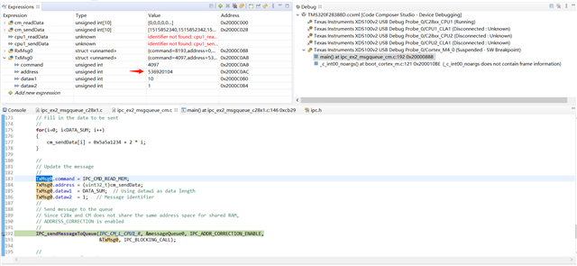

调试:
  • 额,你好,程序里面还请说明一下具体修改的哪些位置的代码。否则一句一句去校对有点费时。
  • 好的,麻烦您了。
    修改位置:
    1、CPU1中增加一个通道,设置接收中断函数,原先的通道停止发送(while(1);)。
    /*******************************************cpu1 read cm send******************************************************************/
        // Enable IPC interrupts
        IPC_registerInterrupt(IPC_CPU1_L_CM_R, IPC_INT0, IPC_ISR0);
        // Initialize message queue
        IPC_initMessageQueue(IPC_CPU1_L_CM_R, &messageQueue0, IPC_INT0, IPC_INT0);
    __interrupt void IPC_ISR0()
        int i;
        bool status = false;
        // Read the message from the message queue
        IPC_readMessageFromQueue(IPC_CPU1_L_CM_R, &messageQueue0, IPC_ADDR_CORRECTION_ENABLE,
                                 &RxMsg0, IPC_NONBLOCKING_CALL);
        if(RxMsg0.command == IPC_CMD_READ_MEM)
            status = true;
            // Read and compare data
            for(i=0; i<RxMsg0.dataw1; i++)
                if(i < DATA_SUM)
                    cpu1_readData[i] = *((uint32_t *)RxMsg0.address + i);
                if(*((uint32_t *)RxMsg0.address + i) != i)
                    status = false;
        // Send response message
        TxMsg0.command = IPC_CMD_RESP;
        TxMsg0.address = 0; // Not used
        TxMsg0.dataw1  = status ? TEST_PASS : TEST_FAIL;
        TxMsg0.dataw2  = RxMsg0.dataw2; // Use the message identifier from the received message
        IPC_sendMessageToQueue(IPC_CPU1_L_CM_R, &messageQueue0, IPC_ADDR_CORRECTION_ENABLE,
                               &TxMsg0, IPC_NONBLOCKING_CALL);
        // Acknowledge the flag
        IPC_ackFlagRtoL(IPC_CPU1_L_CM_R, IPC_FLAG0);
        // Acknowledge the PIE interrupt.
        Interrupt_clearACKGroup(INTERRUPT_ACK_GROUP11);
    2、在M4中,增加新的通道,设置发送
        IPC_initMessageQueue(IPC_CM_L_CPU1_R, &messageQueue0, IPC_INT0, IPC_INT0);
        while(1)
            // Fill in the data to be sent
            for(i=0; i<DATA_SUM; i++)
                cm_sendData[i] = 0x5a5a1234 + 2 * i;
            // Update the message
            TxMsg0.command = IPC_CMD_READ_MEM;
            TxMsg0.address = (uint32_t)cm_sendData;
            TxMsg0.dataw1  = DATA_SUM;  // Using dataw1 as data length
            TxMsg0.dataw2  = 1;   // Message identifier
            // Send message to the queue
            // Since C28x and CM does not share the same address space for shared RAM,
            // ADDRESS_CORRECTION is enabled
            IPC_sendMessageToQueue(IPC_CM_L_CPU1_R, &messageQueue0, IPC_ADDR_CORRECTION_ENABLE,
                                   &TxMsg0, IPC_BLOCKING_CALL);
            // Read message from the queue
            // Return message from CM does not use the address field, hence
            // ADDRESS_COREECTION feature is not used
            IPC_readMessageFromQueue(IPC_CM_L_CPU1_R, &messageQueue0, IPC_ADDR_CORRECTION_DISABLE,
                                     &RxMsg0, IPC_BLOCKING_CALL);
            if((RxMsg0.command == IPC_CMD_RESP) && (RxMsg0.dataw1 == TEST_PASS) && (RxMsg0.dataw2 == 1))
                pass = 1;
            else
                pass = 0;
  • 收到,我会尽快回复

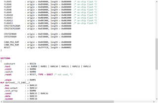

  • IPC 驱动程序函数中的 IPC_ADDR_CORRECTION_ENABLE 功能仅在地址在 IPC MSGRAM 中时才起作用。 例如,如果 CPU1 正在向 CM 发送数据,则地址应在 CPU1_TO_CM_MSGRAM 的地址范围内。
    你这边需要确认一下上述这点是否满足?
  • 谢谢。

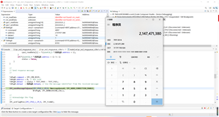

    在CM向CPU1发送时,地址发送端和接收端都超出了范围:
    在CPU1中:
    在CM中:
    代码中address的值,怎么改呢?
  • 如果不使用地址参数,或者用于发送不在 CPU1-CM IPC MSGRAM 范围内的地址,请禁用 ADDRESS_CORRECTION 功能。
    IPC_sendMessageToQueue(.., .., IPC_ADDR_CORRECTION_DISABLE, .. , ..);
    IPC_readMessageFromQueue(.., .., IPC_ADDR_CORRECTION_DISABLE, .. , ..);
  • 禁用ADDRESS_CORRECTION功能,CM有什么办法向CPU1、CPU2传输数据吗?
  • 禁用 ADDRESS_CORRECTION的前提是如果不使用地址参数,或者用于发送不在 CPU1-CM IPC MSGRAM 范围内的地址,这样就可以减少空间使用
  • 这个明白了,谢谢!重点是CM有什么办法向CPU1、CPU2传输数据吗
