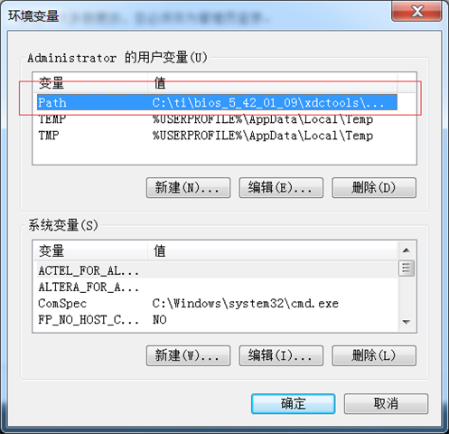

在CCS6.0下编译可以通过,CCS8.3编译出现的问题如下
"C:\\ti\\ccsv8\\utils\\bin\\gmake" -k all
Building file: "../Panda28335.tcf"
Invoking: TConf
"C:/ti/bios_5_42_01_09/xdctools/tconf" -b -Dconfig.importPath="C:/ti/bios_5_42_01_09/packages;" "../Panda28335.tcf"
subdir_rules.mk:12: recipe for target 'build-1701271873-inproc' failed
C:\ti\bios_5_42_01_09\xdctools\C:/ti/bios_5_42_01_09/xdctools/tconf: can't create session manager: create of JVM failed
gmake[1]: *** [build-1701271873-inproc] Error 1
gmake: *** [build-1701271873] Error 2
subdir_rules.mk:9: recipe for target 'build-1701271873' failed
gmake: Target 'all' not remade because of errors.
