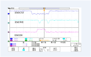

根据emif1_16bit_asram.c修改,配置EMIF模块,在写的过程中EMIWE被拉低两次。这是怎么回事。
代码如下:

#include "F28x_Project.h"
#define ASRAM_CS2_START_ADDR 0x100000
#define ASRAM_CS2_SIZE 0x8000
// Globals
Uint16 ErrCount = 0;
Uint32 TEST_STATUS;
int i;
// Function Prototypes
extern void setup_emif1_pinmux_async_16bit(Uint16);
// mem_read_write - This function performs simple read/write word accesses to memory.
char mem_read_write(Uint32 start_addr, Uint32 mem_size)
//unsigned long mem_rds;
unsigned long mem_wds;
long *XMEM_ps;
//unsigned int i;
//Write data
XMEM_ps = (long *)start_addr;
//Fill memory
mem_wds = 0x1;
//for (i=0; i < mem_size; i++)
//*XMEM_ps++ = mem_wds;
*XMEM_ps = mem_wds;
// mem_wds += 0x11111111;
//Verify memory
mem_wds = 0x01234567;
mem_rds = *XMEM_ps;
if( mem_rds != mem_wds)
return(1);
XMEM_ps++;
return(0);

//Configure to run EMIF1 on full Rate (EMIF1CLK = CPU1SYSCLK)
EALLOW;
ClkCfgRegs.PERCLKDIVSEL.bit.EMIF1CLKDIV = 0x0;
EDIS;
EALLOW;
// Grab EMIF1 For CPU1
Emif1ConfigRegs.EMIF1MSEL.all = 0x93A5CE71;
if(Emif1ConfigRegs.EMIF1MSEL.all != 0x1)
ErrCount++;
//Disable Access Protection (CPU_FETCH/CPU_WR/DMA_WR)
Emif1ConfigRegs.EMIF1ACCPROT0.all = 0x0;
if(Emif1ConfigRegs.EMIF1ACCPROT0.all != 0x0)
ErrCount++;
// Commit the configuration related to protection. Till this bit remains set
// content of EMIF1ACCPROT0 register can't be changed.
Emif1ConfigRegs.EMIF1COMMIT.all = 0x1;
if(Emif1ConfigRegs.EMIF1COMMIT.all != 0x1)
ErrCount++;
// Lock the configuration so that EMIF1COMMIT register can't be
// changed any more.
Emif1ConfigRegs.EMIF1LOCK.all = 0x1;
if(Emif1ConfigRegs.EMIF1LOCK.all != 1)
ErrCount++;
EDIS;
EALLOW;
GpioCtrlRegs.GPBDIR.bit.GPIO32 = 1;//配置方向:0输入;1输出
GpioCtrlRegs.GPBDIR.bit.GPIO33 = 1;
GpioCtrlRegs.GPBPUD.bit.GPIO32 = 0;//上拉:0使能上拉;1禁止上拉
GpioCtrlRegs.GPBPUD.bit.GPIO33 = 0;
GpioDataRegs.GPBCLEAR.bit.GPIO32 = 1;//数据清除:写0无效;写1置为低电平
GpioDataRegs.GPBCLEAR.bit.GPIO33 = 1;//数据清除:写0无效;写1置为低电平
EDIS;
//Configure GPIO pins for EMIF1
setup_emif1_pinmux_async_16bit(0);
Emif1Regs.ASYNC_CS2_CR.bit.ASIZE = 1;//1:0
Emif1Regs.ASYNC_CS2_CR.bit.TA= 10; //3:2
//Emif1Regs.ASYNC_CS2_CR.bit.R_HOLD= 0;//6:4
//Emif1Regs.ASYNC_CS2_CR.bit.R_STROBE = 0;//12:7
//Emif1Regs.ASYNC_CS2_CR.bit.R_SETUP = 0;//16:13
Emif1Regs.ASYNC_CS2_CR.bit.W_HOLD =0;//19:17
Emif1Regs.ASYNC_CS2_CR.bit.W_STROBE =2;//25:20
Emif1Regs.ASYNC_CS2_CR.bit.W_SETUP =0;//29:26
Emif1Regs.ASYNC_CS2_CR.bit.EW = 0;//30
Emif1Regs.ASYNC_CS2_CR.bit.SS = 0;//31
while (1)
ErrCount_local = mem_read_write(ASRAM_CS2_START_ADDR, ASRAM_CS2_SIZE);
ErrCount = ErrCount + ErrCount_local;
DELAY_US(100);
