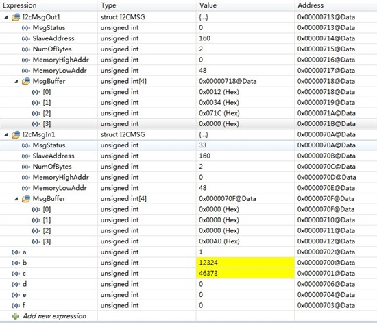

我想说一句:我在用28035的I2C的时候也是没办法与EEPROM通讯,我用的24C02的芯片。问题是用controlsuit上的例程就是不行,没办法测到响应信号,最后只能用I/O口的传通方法来通讯的。到现在我也不知是为什么!
我用的AT24C02,完全用的controlsuit里面的例程,只把地址改成了0xa0,但是读不出数据,不知道怎么回事
#include "DSP28x_Project.h" // Device Headerfile and Examples Include File
// Note: I2C Macros used in this example can be found in the
// DSP2802x_I2C_defines.h file
// Prototype statements for functions found within this file.
void I2CA_Init(void);
Uint16 I2CA_WriteData(struct I2CMSG *msg);
Uint16 I2CA_ReadData(struct I2CMSG *msg);
interrupt void i2c_int1a_isr(void);
void pass(void);
void fail(void);
unsigned int a=0,b=0,c=0,d=0,e=0,f=0;
#define I2C_SLAVE_ADDR 0xa0
#define I2C_NUMBYTES 2
#define I2C_EEPROM_HIGH_ADDR 0x01
#define I2C_EEPROM_LOW_ADDR 0x30
// Global variables
// Two bytes will be used for the outgoing address,
// thus only setup 14 bytes maximum
struct I2CMSG I2cMsgOut1={I2C_MSGSTAT_SEND_WITHSTOP,
I2C_SLAVE_ADDR,
I2C_NUMBYTES,
I2C_EEPROM_HIGH_ADDR,
I2C_EEPROM_LOW_ADDR,
0x12, // Msg Byte 1
0x34}; // Msg Byte 2
struct I2CMSG I2cMsgIn1={ I2C_MSGSTAT_SEND_NOSTOP,
I2C_SLAVE_ADDR,
I2C_NUMBYTES,
I2C_EEPROM_LOW_ADDR};
struct I2CMSG *CurrentMsgPtr; // Used in interrupts
Uint16 PassCount;
Uint16 FailCount;
void main(void)
Uint16 Error;
Uint16 i;
CurrentMsgPtr = &I2cMsgOut1;
// Step 1. Initialize System Control:
// PLL, WatchDog, enable Peripheral Clocks
// This example function is found in the DSP2802x_SysCtrl.c file.
InitSysCtrl();
// Step 2. Initalize GPIO:
// This example function is found in the DSP2802x_Gpio.c file and
// illustrates how to set the GPIO to it's default state.
// InitGpio();
// Setup only the GP I/O only for I2C functionality
InitI2CGpio();
// Step 3. Clear all interrupts and initialize PIE vector table:
// Disable CPU interrupts
DINT;
// Initialize PIE control registers to their default state.
// The default state is all PIE interrupts disabled and flags
// are cleared.
// This function is found in the DSP2802x_PieCtrl.c file.
InitPieCtrl();
// Disable CPU interrupts and clear all CPU interrupt flags:
IER = 0x0000;
IFR = 0x0000;
// Initialize the PIE vector table with pointers to the shell Interrupt
// Service Routines (ISR).
// This will populate the entire table, even if the interrupt
// is not used in this example. This is useful for debug purposes.
// The shell ISR routines are found in DSP2802x_DefaultIsr.c.
// This function is found in DSP2802x_PieVect.c.
InitPieVectTable();
// Interrupts that are used in this example are re-mapped to
// ISR functions found within this file.
EALLOW; // This is needed to write to EALLOW protected registers
PieVectTable.I2CINT1A = &i2c_int1a_isr;
EDIS; // This is needed to disable write to EALLOW protected registers
// Step 4. Initialize all the Device Peripherals:
// This function is found in DSP2802x_InitPeripherals.c
// InitPeripherals(); // Not required for this example
I2CA_Init();
// Step 5. User specific code
// Clear Counters
PassCount = 0;
FailCount = 0;
// Clear incoming message buffer
for (i = 0; i < (I2C_MAX_BUFFER_SIZE - 2); i++)
I2cMsgIn1.MsgBuffer[i] = 0x0000;
// Enable interrupts required for this example
// Enable I2C interrupt 1 in the PIE: Group 8 interrupt 1
PieCtrlRegs.PIEIER8.bit.INTx1 = 1;
// Enable CPU INT8 which is connected to PIE group 8
IER |= M_INT8;
EINT;
// Application loop
for(;;)
// Write data to EEPROM section //
// Check the outgoing message to see if it should be sent.
// In this example it is initialized to send with a stop bit.
if(I2cMsgOut1.MsgStatus == I2C_MSGSTAT_SEND_WITHSTOP)
a++;
Error = I2CA_WriteData(&I2cMsgOut1);
// If communication is correctly initiated, set msg status to busy
// and update CurrentMsgPtr for the interrupt service routine.
// Otherwise, do nothing and try again next loop. Once message is
// initiated, the I2C interrupts will handle the rest. Search for
// ICINTR1A_ISR in the i2c_eeprom_isr.c file.
if (Error == I2C_SUCCESS)
I2cMsgOut1.MsgStatus = I2C_MSGSTAT_WRITE_BUSY;
} // end of write section
// Read data from EEPROM section //
// Check outgoing message status. Bypass read section if status is
// not inactive.
if (I2cMsgOut1.MsgStatus == I2C_MSGSTAT_INACTIVE)
b++;
// Check incoming message status.
if(I2cMsgIn1.MsgStatus == I2C_MSGSTAT_SEND_NOSTOP)
c++;
// EEPROM address setup portion
while(I2CA_ReadData(&I2cMsgIn1) != I2C_SUCCESS)
d++;//未进入
// Maybe setup an attempt counter to break an infinite while

这个是观察到的,说明没有读出数据,不知道为什么
