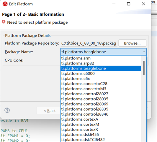

在CCS10,在Tools > RTSC Tools > Platform > Edit/View的页面下Package Name里面为什么找不到28377呢

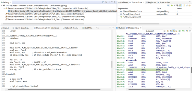

"我们的工程师不明白问题出在哪里——Hwi模块有什么问题?添加后程序以何种方式失败?"
我使用了hwi模块,用EPWM1简单做了一个中断,代码烧录进去点击运行之后,代码自己停在了下图
我把我的代码附上,麻烦帮忙看看是哪里的问题,谢谢
main函数如下:
void main(void)
DINT; // Disable global interrupts
DRTM;
InitSysCtrl();
IER = 0x0000;
IFR = 0x0000;
Uint8 i = 0;
for(i = 0; i < 5; i++)
DELAY_US(1000000);
CpuSysRegs.PCLKCR2.bit.EPWM1=1;
InitEPwm1Gpio();
EALLOW;
CpuSysRegs.PCLKCR0.bit.TBCLKSYNC =0;
EDIS;
InitEPwm1Example();
EALLOW;
CpuSysRegs.PCLKCR0.bit.TBCLKSYNC =1;
EDIS;
EINT; // Enable Global interrupt INTM
ERTM; // Enable Global realtime interrupt DBGM
//EnableInnerDog(); // Enable Inner Software Watchdog
Hwi_enableInterrupt(48);
BIOS_start(); /* does not return */
PLL和外设时钟使能

void InitEPwm1Example()
EPwm1Regs.TBPRD = 6000; // Set timer period
EPwm1Regs.TBPHS.bit.TBPHS = 0x0000; // Phase is 0
EPwm1Regs.TBCTR = 0x0000; // Clear counter
// Setup TBCLK
EPwm1Regs.TBCTL.bit.CTRMODE = TB_COUNT_UPDOWN; // Count up
EPwm1Regs.TBCTL.bit.PHSEN = TB_DISABLE; // Disable phase loading
EPwm1Regs.TBCTL.bit.HSPCLKDIV = TB_DIV4; // Clock ratio to SYSCLKOUT
EPwm1Regs.TBCTL.bit.CLKDIV = TB_DIV4;
EPwm1Regs.CMPCTL.bit.SHDWAMODE = CC_SHADOW; // Load registers every ZERO
EPwm1Regs.CMPCTL.bit.SHDWBMODE = CC_SHADOW;
EPwm1Regs.CMPCTL.bit.LOADAMODE = CC_CTR_ZERO;
EPwm1Regs.CMPCTL.bit.LOADBMODE = CC_CTR_ZERO;
// Setup compare
EPwm1Regs.CMPA.bit.CMPA = 3000;
// Set actions
EPwm1Regs.AQCTLA.bit.CAU = AQ_SET; // Set PWM1A on Zero
EPwm1Regs.AQCTLA.bit.CAD = AQ_CLEAR;
EPwm1Regs.AQCTLB.bit.CAU = AQ_CLEAR; // Set PWM1A on Zero
EPwm1Regs.AQCTLB.bit.CAD = AQ_SET;
// Active Low PWMs - Setup Deadband
EPwm1Regs.DBCTL.bit.OUT_MODE = DB_FULL_ENABLE;
EPwm1Regs.DBCTL.bit.POLSEL = DB_ACTV_LO;
EPwm1Regs.DBCTL.bit.IN_MODE = DBA_ALL;
EPwm1Regs.DBRED.bit.DBRED = 0;
EPwm1Regs.DBFED.bit.DBFED = 0;
// Interrupt where we will change the Deadband
EPwm1Regs.ETSEL.bit.INTSEL = ET_CTR_ZERO; // Select INT on Zero event
EPwm1Regs.ETSEL.bit.INTEN = 1; // Enable INT
EPwm1Regs.ETPS.bit.INTPRD = ET_3RD; // Generate INT on 3rd event
PWM中断服务函数:
// 3.1 - ePWM1 Interrupt
Void EPWM1_ISR()
//Hwi_clearInterrupt(48);
GpioDataRegs.GPATOGGLE.bit.GPIO3 = 1;
EPwm1TimerIntCount++;
if(EPwm1TimerIntCount > 1000)
EPwm1TimerIntCount = 0;
// Clear INT flag for this timer
EPwm1Regs.ETCLR.bit.INT = 1;
// Acknowledge this interrupt to receive more interrupts from group 3
PieCtrlRegs.PIEACK.all = PIEACK_GROUP3;
//Hwi_enableInterrupt(48);

所以程序是陷入了Hwi调度例程内的循环吗?这个问题是在调用 BIOS_start 之前还是之后发生的?是否检查过 ROV 的 Hwi 状态或任何报告的错误?
是陷入了hwi调度那里,BIOS_Start之后发生的,ROV怎么使用?使用ROV时提示Error: ROV only supports Elf object files,请问这个文件是编译器生成的吗?一般存放在哪呢?
