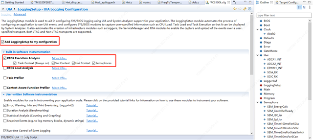

  1. Goles: Analyzing the Execution Sequence with RTOS Analyzer

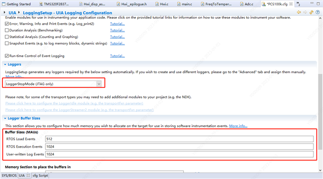

1.2 The configuration of the UIA  "Logging Setup"

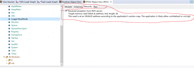

Received exception from ROV:server Target memory read failed at address :0x04, length :26,This read is an
INVALID address according to the application's section map .The application is likely either unintialized or corrupt.
I can not get  messaage from the  "RTOS Object View " "Records".  See the up picture.
2.2
But when the debug is running for 3 senonds ,then hold the debug , it will get some messangs . See the bellow picture.
