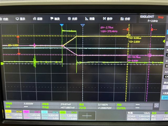

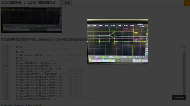

用28335的ADC进行差分采样时遇到一个问题:我用ADC的A0和B0同时采两路信号如下图的黄色波形和紫色波形
具体是捕获绿色波形的下降沿,进中断触发ADC采样黄色波形和紫色波形8次,ADC采样的配置如下

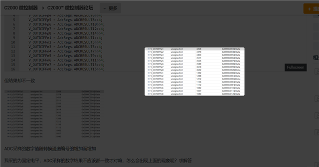

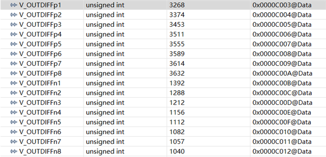

采样结果分别放到了下面的变量里:
    V_OUTDIFFp1 = AdcRegs.ADCRESULT0>>4;
    V_OUTDIFFp2 = AdcRegs.ADCRESULT2>>4;
    V_OUTDIFFp3 = AdcRegs.ADCRESULT4>>4;
    V_OUTDIFFp4 = AdcRegs.ADCRESULT6>>4;
    V_OUTDIFFp5 = AdcRegs.ADCRESULT8>>4;
    V_OUTDIFFp6 = AdcRegs.ADCRESULT10>>4;
    V_OUTDIFFp7 = AdcRegs.ADCRESULT12>>4;
    V_OUTDIFFp8 = AdcRegs.ADCRESULT14>>4;
    V_OUTDIFFn1 = AdcRegs.ADCRESULT1>>4;
    V_OUTDIFFn2 = AdcRegs.ADCRESULT3>>4;
    V_OUTDIFFn3 = AdcRegs.ADCRESULT5>>4;
    V_OUTDIFFn4 = AdcRegs.ADCRESULT7>>4;
    V_OUTDIFFn5 = AdcRegs.ADCRESULT9>>4;
    V_OUTDIFFn6 = AdcRegs.ADCRESULT11>>4;
    V_OUTDIFFn7 = AdcRegs.ADCRESULT13>>4;
    V_OUTDIFFn8 = AdcRegs.ADCRESULT15>>4;
但结果却不一致
ADC采样的数字值随转换通道编号的增加而增加
我采的为固定电平,ADC采样的数字结果不应该都一致才对嘛,怎么会出现上面的现象呢?求解答
