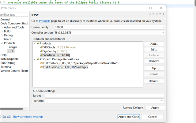

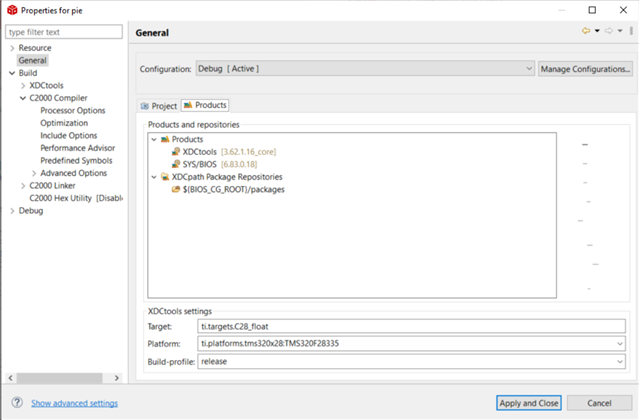

TMS320F28335: RTSC工程错误
Part Number: TMS320F28335
description Resource Path Location Type xdc.tools.configuro: Error: Can't find the platform package 'ti.platforms.tms320x28'. TI platforms are no longer shipped as part of XDCtools (D:\CCS\xdctools_3_62_01_16_core). Please ensure you are either using a pre-3.30 version of XDCtools or you have added a product that includes your platform support along the path 'D:/ccs_prj/RTSC_Board/myBoard/package;D:\CCS\xdctools_3_62_01_16_core/packages'. Check that this path names a directory containing the necessary platform support and that the platform name is properly spelled. .xdchelp /RTSC_1 line 52 C/C++ Problem
