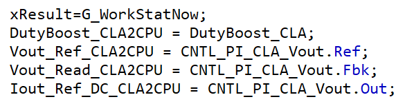

//Task 2 (C) Variables #pragma DATA_SECTION(xInput,"CpuToCla1MsgRAM"); long xInput; #pragma DATA_SECTION(xResult,"Cla1ToCpuMsgRAM"); long xResult; #pragma DATA_SECTION(DutyBuck_CLA,"CpuToCla1MsgRAM") volatile float32 DutyBuck_CLA; #pragma DATA_SECTION(DutyBoost_CLA,"Cla1DataRam1") volatile float32 DutyBoost_CLA; #pragma DATA_SECTION(DutyBoost_CLA2CPU,"Cla1ToCpuMsgRAM"); volatile float32 DutyBoost_CLA2CPU; #pragma DATA_SECTION(Ipv_Read_CLA,"Cla1DataRam1") #pragma DATA_SECTION(Vpv_Read_CLA,"Cla1DataRam1") #pragma DATA_SECTION(Iout_Read_CLA,"Cla1DataRam1") #pragma DATA_SECTION(Vout_Read_CLA,"Cla1DataRam1") volatile float32 Ipv_Read_CLA,Vpv_Read_CLA,Iout_Read_CLA,Vout_Read_CLA; #pragma DATA_SECTION(Vpv_Ref_CLA,"CpuToCla1MsgRAM") volatile float32 Vpv_Ref_CLA; #pragma DATA_SECTION(Vout_Ref_CLA,"CpuToCla1MsgRAM") volatile float32 Vout_Ref_CLA; #pragma DATA_SECTION(Iout_Ref_DC_CLA,"Cla1DataRam1") #pragma DATA_SECTION(Iout_Ref_CL_CLA,"Cla1DataRam1") #pragma DATA_SECTION(Iout_Ref_MPPT_CLA,"Cla1DataRam1") volatile float32 Iout_Ref_DC_CLA,Iout_Ref_CL_CLA,Iout_Ref_MPPT_CLA; #pragma DATA_SECTION(MATH_EMAVG_CLA_Ipv, "Cla1ToCpuMsgRAM") MATH_EMAVG_CLA MATH_EMAVG_CLA_Ipv; #pragma DATA_SECTION(MATH_EMAVG_CLA_Vpv, "Cla1ToCpuMsgRAM") MATH_EMAVG_CLA MATH_EMAVG_CLA_Vpv; #pragma DATA_SECTION(MATH_EMAVG_CLA_Iout, "Cla1ToCpuMsgRAM") MATH_EMAVG_CLA MATH_EMAVG_CLA_Iout; #pragma DATA_SECTION(MATH_EMAVG_CLA_Vout, "Cla1ToCpuMsgRAM") MATH_EMAVG_CLA MATH_EMAVG_CLA_Vout; #pragma DATA_SECTION(CNTL_PI_CLA_Vpv, "Cla1DataRam1") volatile CNTL_PI_CLA CNTL_PI_CLA_Vpv; #pragma DATA_SECTION(CNTL_PI_CLA_Vout, "Cla1DataRam1") volatile CNTL_PI_CLA CNTL_PI_CLA_Vout; #pragma DATA_SECTION(CNTL_PI_CLA_Iout, "Cla1DataRam1") volatile CNTL_PI_CLA CNTL_PI_CLA_Iout; #pragma DATA_SECTION(Vout_Ref_CLA2CPU,"Cla1ToCpuMsgRAM"); volatile float32 Vout_Ref_CLA2CPU; #pragma DATA_SECTION(Vout_Read_CLA2CPU,"Cla1ToCpuMsgRAM"); volatile float32 Vout_Read_CLA2CPU; #pragma DATA_SECTION(Iout_Ref_DC_CLA2CPU,"Cla1ToCpuMsgRAM"); volatile float32 Iout_Ref_DC_CLA2CPU;
shared.h
//Task 2 (C) Variables extern Uint16 G_WorkStatNow; extern long xInput; extern long xResult; extern volatile float32 DutyBuck_CLA; extern volatile float32 DutyBoost_CLA; extern volatile float32 DutyBoost_CLA2CPU; extern volatile float32 Ipv_Read_CLA,Vpv_Read_CLA,Iout_Read_CLA,Vout_Read_CLA; extern volatile float32 Vpv_Ref_CLA; extern volatile float32 Vout_Ref_CLA; extern volatile float32 Iout_Ref_DC_CLA,Iout_Ref_CL_CLA,Iout_Ref_MPPT_CLA; extern MATH_EMAVG_CLA MATH_EMAVG_CLA_Ipv; extern MATH_EMAVG_CLA MATH_EMAVG_CLA_Vpv; extern MATH_EMAVG_CLA MATH_EMAVG_CLA_Iout; extern MATH_EMAVG_CLA MATH_EMAVG_CLA_Vout; extern volatile CNTL_PI_CLA CNTL_PI_CLA_Vpv; extern volatile CNTL_PI_CLA CNTL_PI_CLA_Vout; extern volatile CNTL_PI_CLA CNTL_PI_CLA_Iout; extern volatile float32 Vout_Ref_CLA2CPU; extern volatile float32 Vout_Read_CLA2CPU; extern volatile float32 Iout_Ref_DC_CLA2CPU;
cla.cla 感觉运行不正常的是CNTL_PI_CLA_MACRO()函数

xResult=G_WorkStatNow;
DutyBoost_CLA2CPU = DutyBoost_CLA;
Vout_Ref_CLA2CPU = CNTL_PI_CLA_Vout.Ref;
Vout_Read_CLA2CPU = CNTL_PI_CLA_Vout.Fbk;
Iout_Ref_DC_CLA2CPU = CNTL_PI_CLA_Vout.Out;
