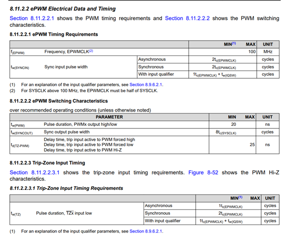

您好,请问TZ引脚对PWM进行同步的延迟大约是多少,这个延迟和EPWM的周期有关系吗,我现在设置的PWM计数周期是20nsTZ引脚对PWM的同步延迟有170ns想问一下这个有方法解决吗?谢谢
你好,参考下工程师的回复:
We tested this out on our end and were unable to reproduce the delay you are seeing so far. If you turn off synchronization, do you still see the same delay? There is an inherent 25ns delay for the trip to take effect (described in the datasheet) as well some delay from InputXBAR and GPIO synchronization.
