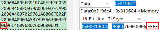

CCS version :12.3.0    Burner version to flash :USB100V3
 Question 1. The address 96C4 compiles 6 words counters in Intel-hex, but there are only 5 (96C40096BD76000006D1),why?
                    96C4这个地址在Intel-hex中编译有6个words counter,实际只有5个(96C40096BD76000006D1),为什么?
 Question 2. The valid data in the 96C4 address Intel-Hex file is 96BD76000006, why is it changed to 96BD76000006FFFF by writing to Flash through the burner?
                   在96C4地址Intel-Hex文件中有效数据为96BD76000006,为什么通过烧录器写进Flash变成了96BD76000006FFFF?
