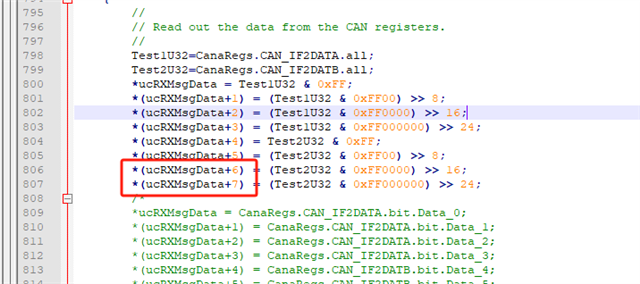

TMS320F28377D: CANA 查询接受帧数据,偶尔会接收错误
Part Number: TMS320F28377D
用can上位机模拟下发给dsp一帧固定的8个字节数据,dsp接收的,偶尔会有接收错误。调用的这个函数(getCANAMessage),查询接受CAN接收的数据,这个数组(ucRXMsgData),接收的数据,偶尔会有高字节的,数据不对。当前,每间隔4ms,调用一次getCANAMessage函数,CAN上位机间隔20ms发送一帧数据。
在线等!

uint16_t getCANAMessage(uint32_t objID,uint32_t *ui32ArbReg,Uint8 *ucRXMsgData)
    uint16_t status;
    // Use Shadow variable for IF2CMD. IF2CMD should be written to in
    // single 32-bit write.
    union CAN_IF2CMD_REG CAN_IF2CMD_SHADOW;
    // Set the Message Data A, Data B, and control values to be read
    // on request for data from the message object.
    CAN_IF2CMD_SHADOW.all = 0;
    CAN_IF2CMD_SHADOW.bit.Control = 1;
    CAN_IF2CMD_SHADOW.bit.DATA_A = 1;
    CAN_IF2CMD_SHADOW.bit.DATA_B = 1;
	CAN_IF2CMD_SHADOW.bit.Arb = 1;       //Enable reading of arbitration bits
    // Transfer the message object to the message object IF register.
    CAN_IF2CMD_SHADOW.bit.MSG_NUM = objID;
    CanaRegs.CAN_IF2CMD.all = CAN_IF2CMD_SHADOW.all;
    // Wait for busy bit to clear.
    while(CanaRegs.CAN_IF2CMD.bit.Busy)
	*ui32ArbReg = CanaRegs.CAN_IF2ARB.all;
    // See if there is new data available.
    if(CanaRegs.CAN_IF2MCTL.bit.NewDat == 1)
        // Read out the data from the CAN registers.
        Test1U32=CanaRegs.CAN_IF2DATA.all;
        Test2U32=CanaRegs.CAN_IF2DATB.all;
        *ucRXMsgData = Test1U32 & 0xFF;
        *(ucRXMsgData+1) = (Test1U32 & 0xFF00) >> 8;
        *(ucRXMsgData+2) = (Test1U32 & 0xFF0000) >> 16;
        *(ucRXMsgData+3) = (Test1U32 & 0xFF000000) >> 24;
        *(ucRXMsgData+4) = Test2U32 & 0xFF;
        *(ucRXMsgData+5) = (Test2U32 & 0xFF00) >> 8;
        *(ucRXMsgData+6) = (Test2U32 & 0xFF0000) >> 16;
        *(ucRXMsgData+7) = (Test2U32 & 0xFF000000) >> 24;
		*ucRXMsgData = CanaRegs.CAN_IF2DATA.bit.Data_0;
		*(ucRXMsgData+1) = CanaRegs.CAN_IF2DATA.bit.Data_1;
		*(ucRXMsgData+2) = CanaRegs.CAN_IF2DATA.bit.Data_2;
		*(ucRXMsgData+3) = CanaRegs.CAN_IF2DATA.bit.Data_3;
		*(ucRXMsgData+4) = CanaRegs.CAN_IF2DATB.bit.Data_4;
		*(ucRXMsgData+5) = CanaRegs.CAN_IF2DATB.bit.Data_5;
		*(ucRXMsgData+6) = CanaRegs.CAN_IF2DATB.bit.Data_6;
		*(ucRXMsgData+7) = CanaRegs.CAN_IF2DATB.bit.Data_7;
        // Populate Shadow Variable
        //CAN_IF2CMD_SHADOW.all = CanaRegs.CAN_IF2CMD.all;
        //CAN_IF2CMD_SHADOW.bit.DATA_A = 1;
        //CAN_IF2CMD_SHADOW.bit.DATA_B = 1;
        // Clear New Data Flag
        CAN_IF2CMD_SHADOW.bit.TxRqst = 1;
        status = true;
        CanaRegs.CAN_IF2MCTL.bit.NewDat = 0;
    else
        status = false;
    return(status);
