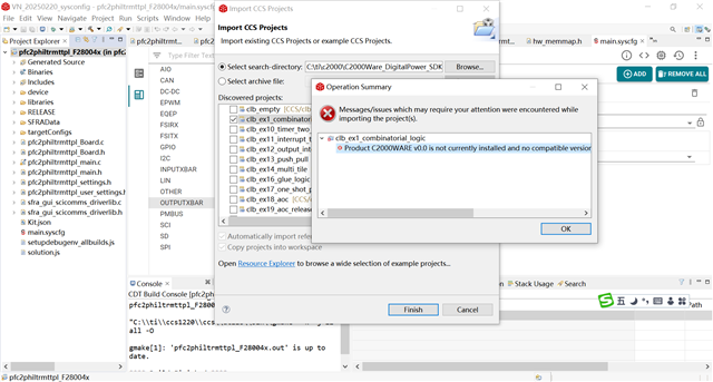

I'm using CCS version 12.2.0. I've installed C2000Ware_DigitalPower_SDK_5_03_00_00 and can see its path in the products interface. However, when I import the projectspec file from the official C2000 example routines, I get an error message saying "See details below... clb_ex1_combinatorial_logic Product C2000WARE v0.0 is not currently installed and no compatible version is available. Please install this product or a compatible version." What should I do?

The error shown here looks to reflect that the C2000Ware product is not discovered in your CCS installation. Can you double check and see if you can edit the path to the C2000Ware product to point to the location within the DigitalPower-SDK. You may need to rediscover the product in order to get it to work.
