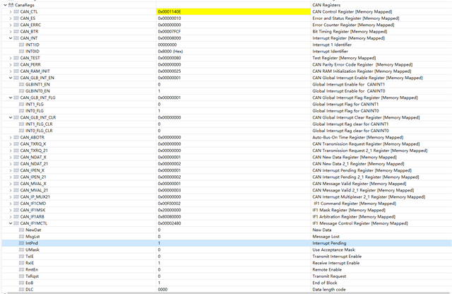

To help diagnose the problem, I am providing the relevant configuration details from SysConfig and the runtime register values below:

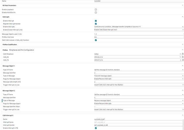

    似乎在 PIE 中注册和启用了 ISR INT_myCAN0_0_ISR。 如果使用了 SysConfig 来配置,中断注册和启用通常在 Board_init ()函数中完成。 您能否检查 board.c 文件中是否生成了中断函数?
  • board.c中没有生成中断函数,以下是board.c中关于can的配置
    void myCAN0_init(){
    	CAN_initModule(myCAN0_BASE);
    	// Refer to the Driver Library User Guide for information on how to set
    	// tighter timing control. Additionally, consult the device data sheet
    	// for more information about the CAN module clocking.
    	CAN_setBitTiming(myCAN0_BASE, 15, 0, 15, 7, 3);
    	// Enable CAN Interrupts
    	CAN_enableInterrupt(myCAN0_BASE, CAN_INT_ERROR|CAN_INT_IE0|CAN_INT_STATUS);
    	CAN_enableGlobalInterrupt(myCAN0_BASE, CAN_GLOBAL_INT_CANINT0);
    	// Initialize the transmit message object used for sending CAN messages.
    	// Message Object Parameters:
    	//      Message Object ID Number: 1
    	//      Message Identifier: 2
    	//      Message Frame: CAN_MSG_FRAME_STD
    	//      Message Type: CAN_MSG_OBJ_TYPE_TX
    	//      Message ID Mask: 0
    	//      Message Object Flags: CAN_MSG_OBJ_RX_INT_ENABLE
    	//      Message Data Length: 2 Bytes
    	CAN_setupMessageObject(myCAN0_BASE, 1, myCAN0_MessageObj1_ID, CAN_MSG_FRAME_STD,CAN_MSG_OBJ_TYPE_TX, 0, CAN_MSG_OBJ_RX_INT_ENABLE,2);
    	//      Message Object ID Number: 2
    	//      Message Type: CAN_MSG_OBJ_TYPE_RX
    	//      Message Data Length: 0 Bytes
    	CAN_setupMessageObject(myCAN0_BASE, 2, myCAN0_MessageObj2_ID, CAN_MSG_FRAME_STD,CAN_MSG_OBJ_TYPE_RX, 0, CAN_MSG_OBJ_RX_INT_ENABLE,0);
    	CAN_setInterruptMux(myCAN0_BASE, 0);
    	// Start CAN module operations
    	CAN_startModule(myCAN0_BASE);
    另外,INT_myCAN0_0_ISR()函数在board.h中进行了声明。“extern __interrupt void INT_myCAN0_0_ISR(void);”
