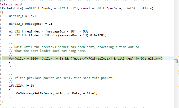

  • TMS570LS1114 Bootloader issue
    Hi Expert
    # 1 In the  underlying source code of Bootloader , the PacketWrite function aways keeped waiting status.   the PC machine always can't complete the datas from under level , what are the reasons?
    Step1:Test PacketWrite funtion.
    the code always…
