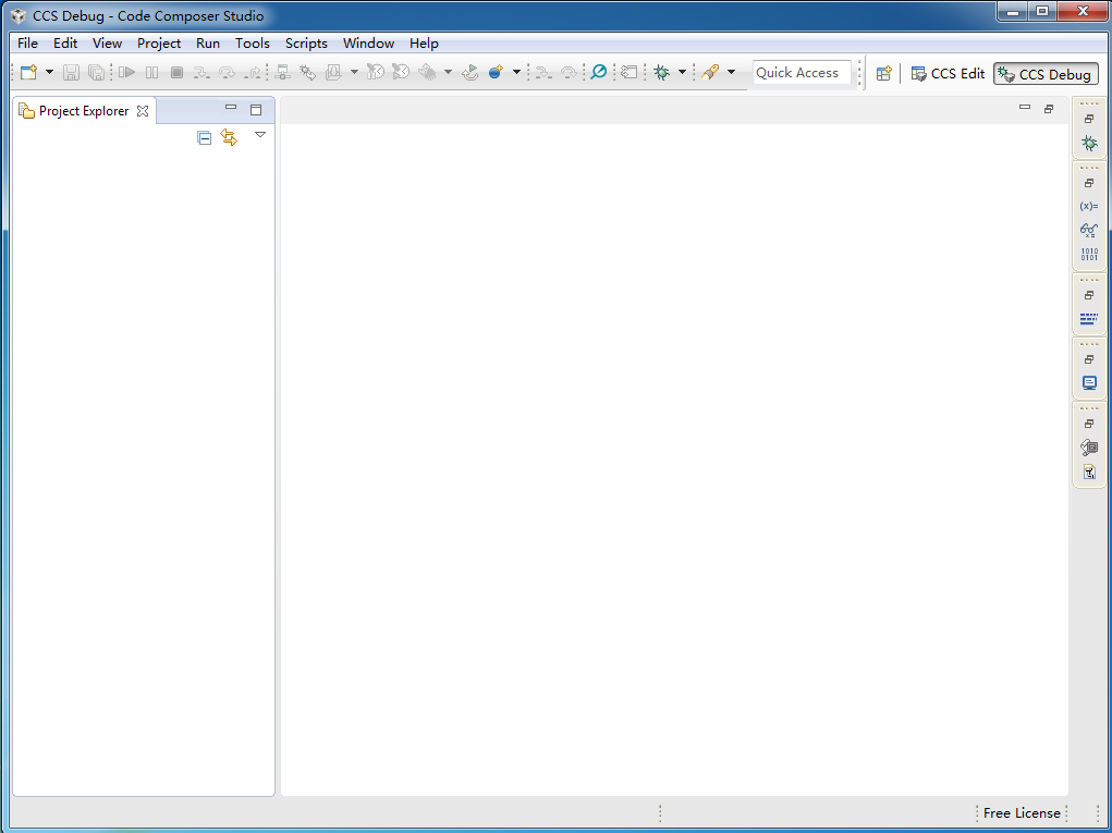

第二步:

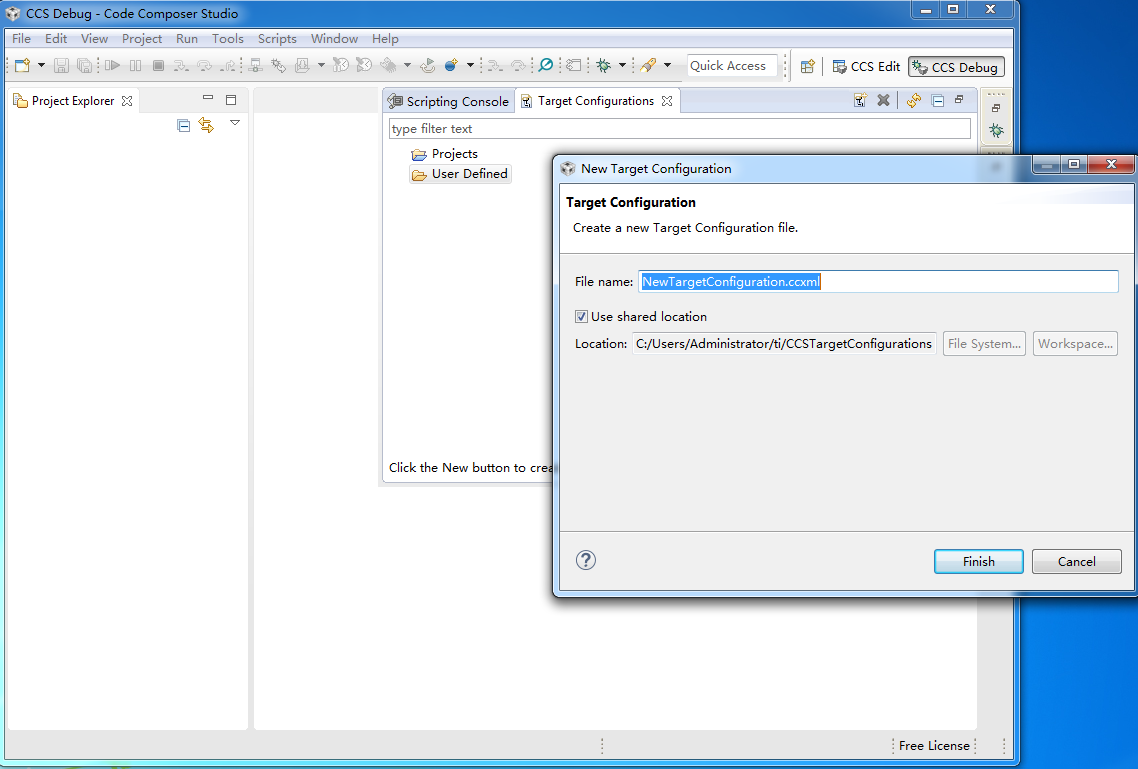

Select View → Target Configuration (Figure 5, left side of image)
• Right click on the User Defined folder and select New Target Configuration
如图2
图2

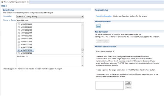

第三步:
选择MCU型号并保存,如图3
图3

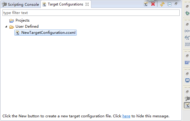

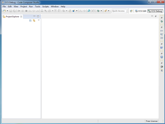

第四步:
Go back to View → Target Configurations
如图4
图4

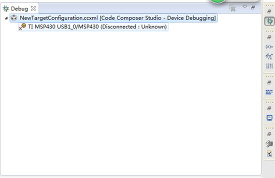

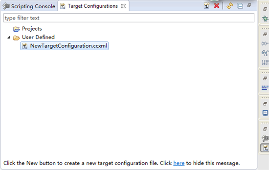

第五步:
Right click your newly created Target Configuration file and select Launch Selected
Configuration,
得到图5
图5

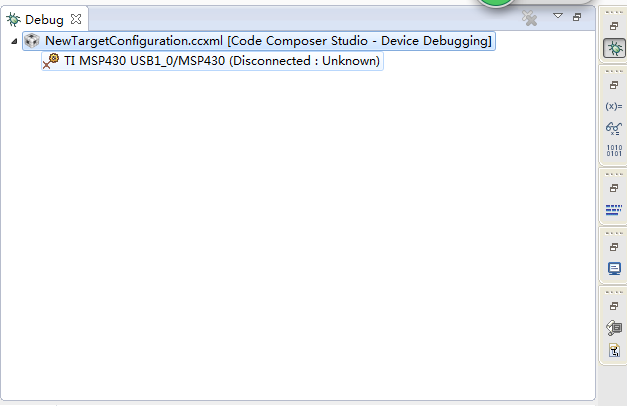

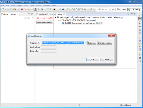

第六步:

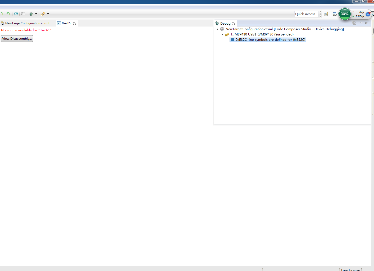

In the Debug Menu, right click on the TI MSP430 USB1_0 connection and select Connect Target
得到图6

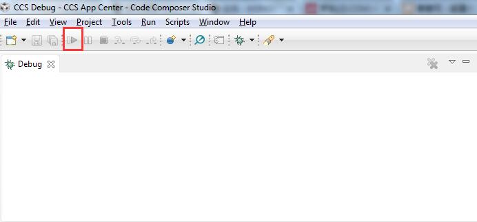

我的问题来了,左边显示红色字体No source available for "0xe32c" 是不是有问题呀
图6

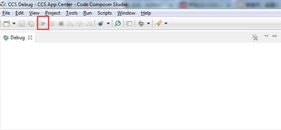

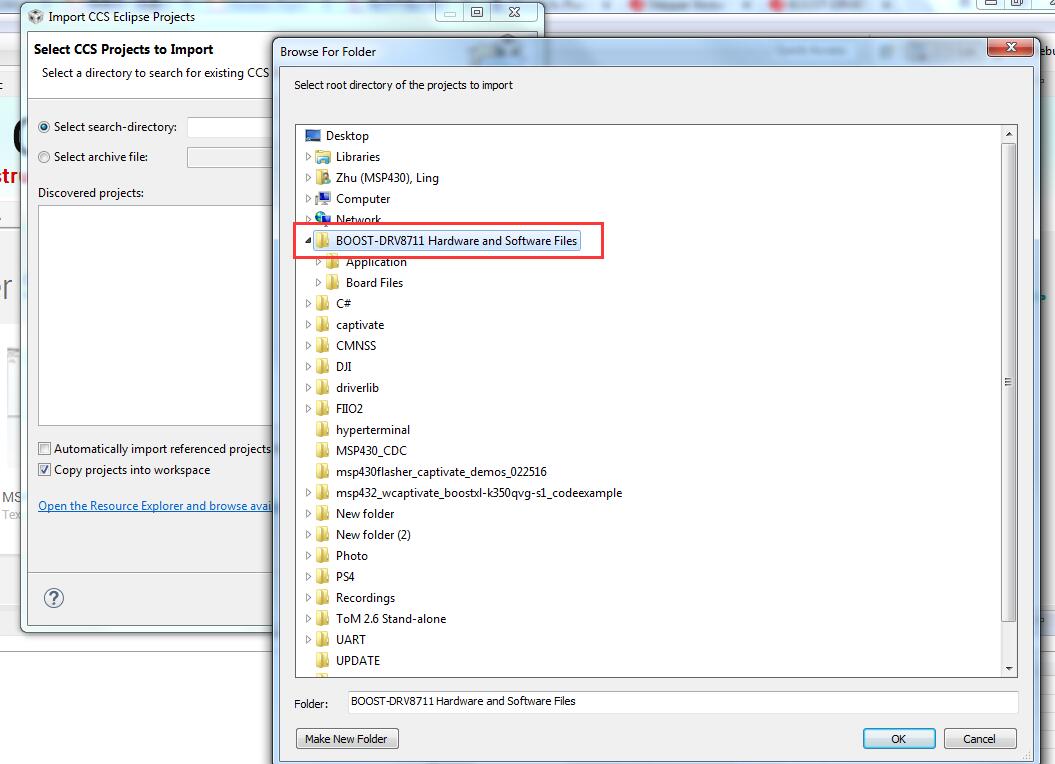

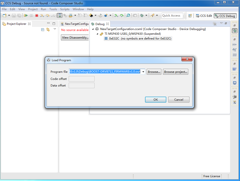

After the device connects, go to Run → Load → Load Program (Figure 9). Browse to the
BOOST-DRV8711 Hardware and Software Files folder that was downloaded from the tool folder.
Go into the Application subdirectory and then go into the GUI subdirectory. Select the
appProgram.out file (Application\BOOST-DRV8711_GUIvX.X\appProgram.out).
导入out文件得到图7
图7

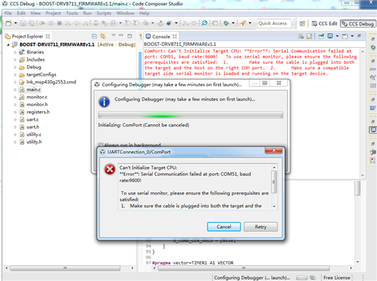

第八步:

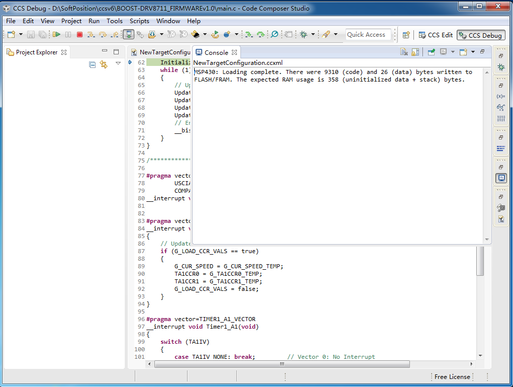

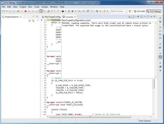

由第七步点OK后就得到图8
图8

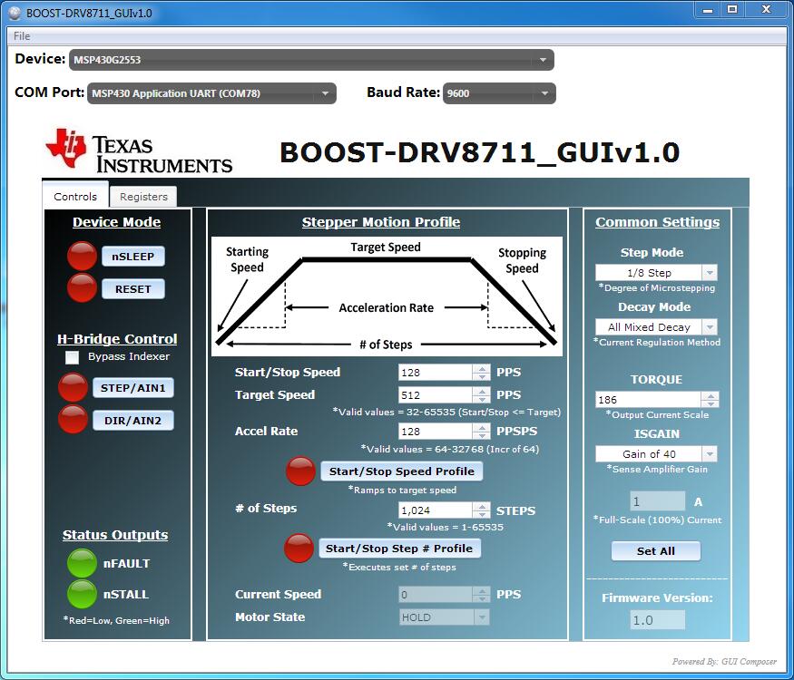

图9

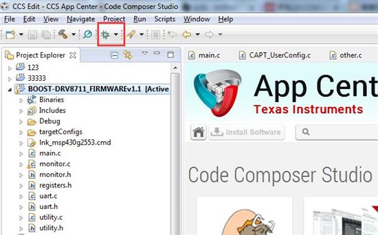

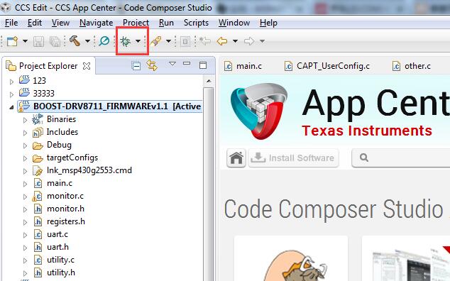

图9是不是显示有问题呀! 程序并没有按我的意思去跑,我想是不是哪里配置不对还是什么的,请相关技术人员帮看下,谢谢!

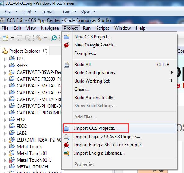

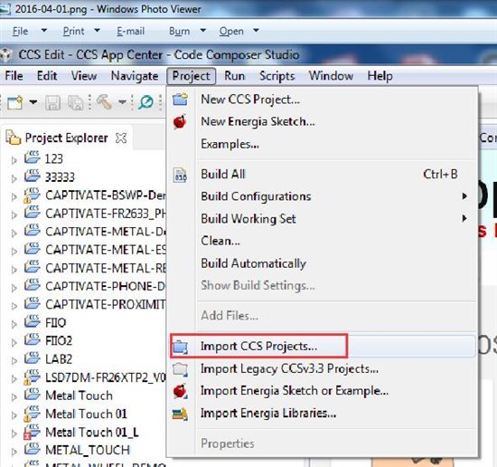

你用的CCS上哪个版本的,我用的是Code Composer Studio 6.1.2。当我导入的时候,总是提示路径错误的,请问文件要放在哪个位置?我是直接放在安装目录下的!

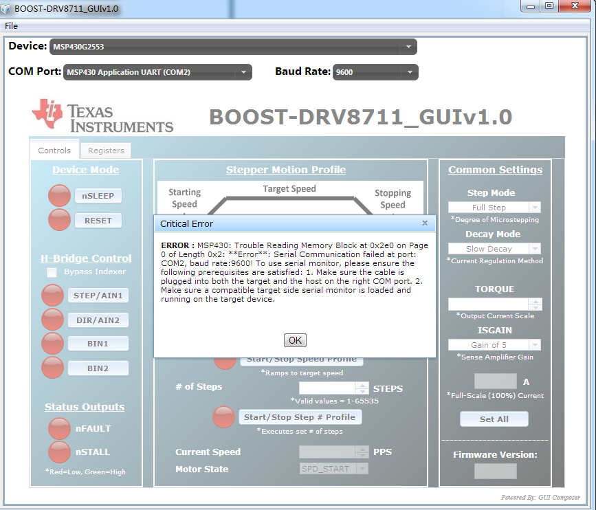

ComPort: Can't Initialize Target CPU: **Error**: Serial Communication failed at port: COM51, baud rate:9600! To use serial monitor, please ensure the following prerequisites are satisfied: 1. Make sure the cable is plugged into both the target and the host on the right COM port. 2. Make sure a compatible target side serial monitor is loaded and running on the target device.
是不是还要配置一些东西,我debug的时候就跳出
信息了!
我大概知道问题了
你装 . http://processors.wiki.ti.com/index.php/Category:GUI_Composer#GUI_Composer_Downloads 了没?
