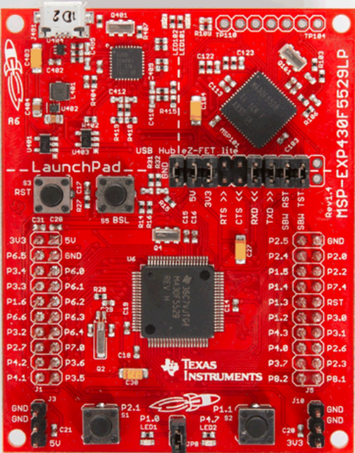

我买了这个单片机,只有一根USB线,插上电脑后驱动也装好了
,那么我能直接通过USB与PC通信吗?需要用额外的线吗?网上找了好多,是不是要动跳线帽?新手自学太困难了,谁能告诉我怎么接吗?

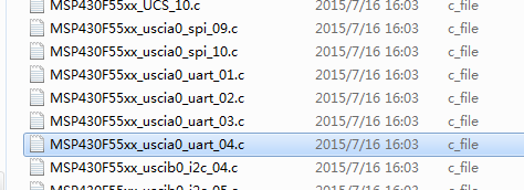

#include <msp430f5529.h>
void main(void)
WDTCTL = WDTPW + WDTHOLD; // Stop WDT
P3SEL = BIT3+BIT4; // P3.4,5 = USCI_A0 TXD/RXD
UCA0CTL1 |= UCSWRST; // **Put state machine in reset**
UCA0CTL1 |= UCSSEL_2; // SMCLK
UCA0BR0 = 6; // 1MHz 9600 (see User's Guide)
UCA0BR1 = 0; // 1MHz 9600
UCA0MCTL = UCBRS_0 + UCBRF_13 + UCOS16; // Modln UCBRSx=0, UCBRFx=0,
// over sampling
UCA0CTL1 &= ~UCSWRST; // **Initialize USCI state machine**
UCA0IE |= UCRXIE; // Enable USCI_A0 RX interrupt
__bis_SR_register(LPM0_bits + GIE); // Enter LPM0, interrupts enabled
__no_operation(); // For debugger
// Echo back RXed character, confirm TX buffer is ready first
#pragma vector=USCI_A0_VECTOR
__interrupt void USCI_A0_ISR(void)
switch(__even_in_range(UCA0IV,4))
case 0:break; // Vector 0 - no interrupt
case 2: // Vector 2 - RXIFG
while (!(UCA0IFG&UCTXIFG)); // USCI_A0 TX buffer ready?
UCA0TXBUF = UCA0RXBUF; // TX -> RXed character
break;
case 4:break; // Vector 4 - TXIFG
default: break;
PC发送过去接收不到返回数据,是哪边有问题呢?
