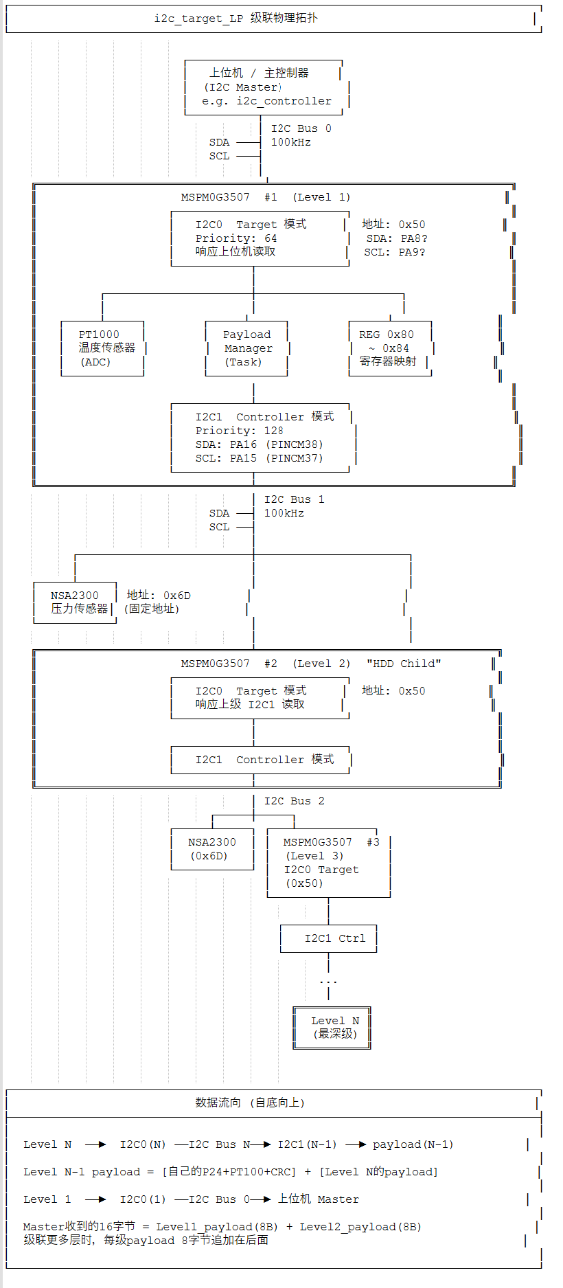

I have an MSPM0G3507 with I2C0 as Target (responding to an upstream master at 0x50) and I2C1 as Controller (reading an NSA2300 sensor at 0x6D and a downstream MCU at 0x50 on a separate physical bus). Both I2C instances run at 100kHz.

After this sequence, I2C_open() returns a non-NULL handle (success), and I2C_transfer() returns true (transfer queued). But the transfer callback never fires. The ISR (I2C1_IRQHandler) appears to stop triggering entirely. Every subsequent transfer times out the same way — I2C_transfer() returns true, but the callback never runs, even for transactions where the slave ACKs its address.
