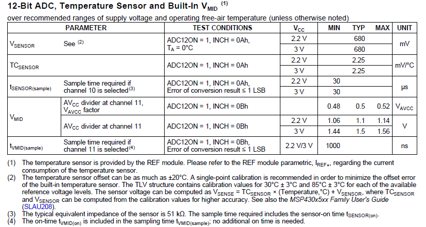

关于MSP430F5438A内部温度传感器问题
1、关于内部温度传感器如何使用?
2、如何将内部采集的值转化为实际的温度值?
  • mspware里有例程

    //  Note:Use the TLV calibrated temperature to measure temperature
    // (the TLV CALIBRATED DATA IS STORED IN THE INFORMATION SEGMENT, SEE DEVICE DATASHEET)

    #define CALADC12_15V_30C  *((unsigned int *)0x1A1A)   // Temperature Sensor Calibration-30 C
                                                          //See device datasheet for TLV table memory mapping
    #define CALADC12_15V_85C  *((unsigned int *)0x1A1C)   // Temperature Sensor Calibration-85 C

        // Temperature in Celsius. See the Device Descriptor Table section in the
        // System Resets, Interrupts, and Operating Modes, System Control Module
        // chapter in the device user's guide for background information on the
        // used formula.
        temperatureDegC = (float)(((long)temp - CALADC12_15V_30C) * (85 - 30)) /
                (CALADC12_15V_85C - CALADC12_15V_30C) + 30.0f;
        // Temperature in Fahrenheit Tf = (9/5)*Tc + 32
        temperatureDegF = temperatureDegC * 9.0f / 5.0f + 32.0f;

  • 楼上正解,但是要注意的是片内温度传感器的精度不高,偏差也会比较大,而且测到的是片内的温度,隔着一层封装呢。
    用的时候要注意
