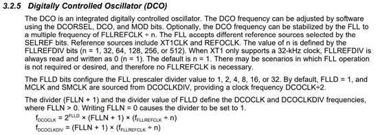

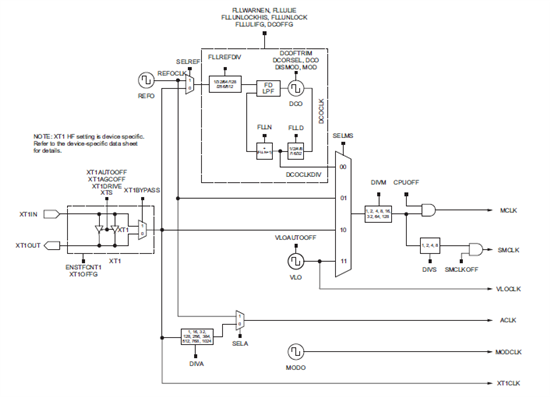

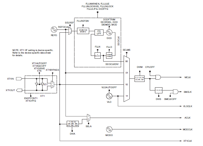

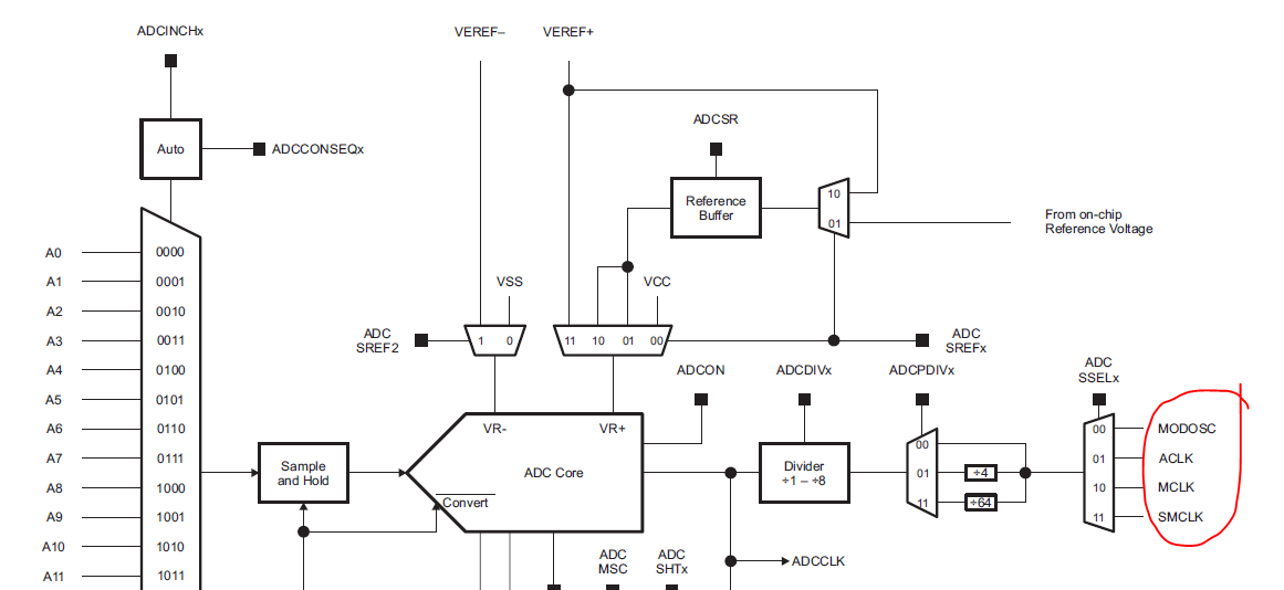

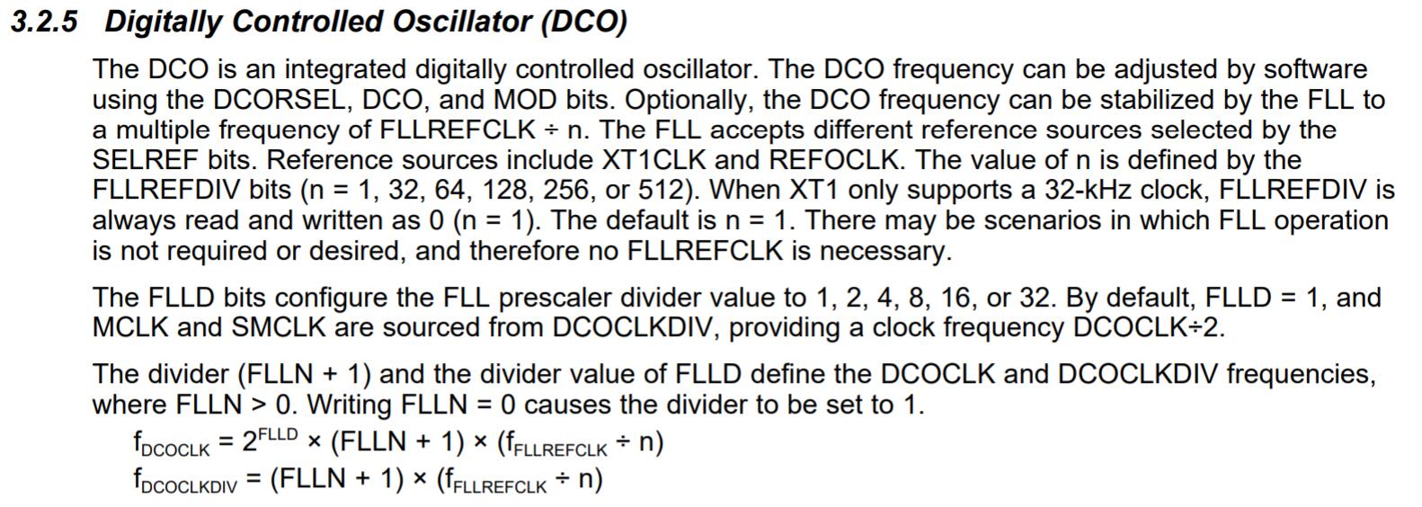

刚入手MSP430FR2311,看过多次数据手册了,对它的时钟系统还没有理解透,如果我使用片内振荡器,如何让CPU 和AD工作在最快频率上?最好给个例程。谢了!(千万不要说再看看数据手册的话,如果能看明白,就不会在这问了)

// MSP430FR231x Demo - Configure MCLK for 16MHz operation, and REFO sourcing
// FLLREF and ACLK.
// Description: Configure MCLK for 16MHz. FLL reference clock is REFO. At this
// speed, the FRAM requires wait states.
// ACLK = default REFO ~32768Hz, SMCLK = MCLK = 16MHz.
// Toggle LED to indicate that the program is running.
// MSP430FR2311
// --|RST |
// | P1.2 |---> LED
// | P1.0 |---> SMCLK = 16MHz
// | P1.1 |---> ACLK = 32768Hz
// Darren Lu
// Texas Instruments Inc.
// July 2015
// Built with IAR Embedded Workbench v6.30 & Code Composer Studio v6.1
#include <msp430.h>
int main(void)
WDTCTL = WDTPW | WDTHOLD; // Stop watchdog timer
// Configure one FRAM waitstate as required by the device datasheet for MCLK
// operation beyond 8MHz _before_ configuring the clock system.
FRCTL0 = FRCTLPW | NWAITS_1;
__bis_SR_register(SCG0); // disable FLL
CSCTL3 |= SELREF__REFOCLK; // Set REFO as FLL reference source
CSCTL0 = 0; // clear DCO and MOD registers
CSCTL1 &= ~(DCORSEL_7); // Clear DCO frequency select bits first
CSCTL1 |= DCORSEL_5; // Set DCO = 16MHz
CSCTL2 = FLLD_0 + 487; // DCOCLKDIV = 16MHz
__delay_cycles(3);
__bic_SR_register(SCG0); // enable FLL
while(CSCTL7 & (FLLUNLOCK0 | FLLUNLOCK1)); // FLL locked
CSCTL4 = SELMS__DCOCLKDIV | SELA__REFOCLK; // set default REFO(~32768Hz) as ACLK source, ACLK = 32768Hz
// default DCOCLKDIV as MCLK and SMCLK source
P1DIR |= BIT0 | BIT1 | BIT2; // set ACLK SMCLK and LED pin as output
P1SEL1 |= BIT0 | BIT1; // set ACLK and SMCLK pin as second function
PM5CTL0 &= ~LOCKLPM5; // Disable the GPIO power-on default high-impedance mode
// to activate previously configured port settings
while(1)
P1OUT ^= BIT2; // Toggle P1.2 using exclusive-OR
__delay_cycles(8000000); // Delay for 8000000*(1/MCLK)=0.5s
