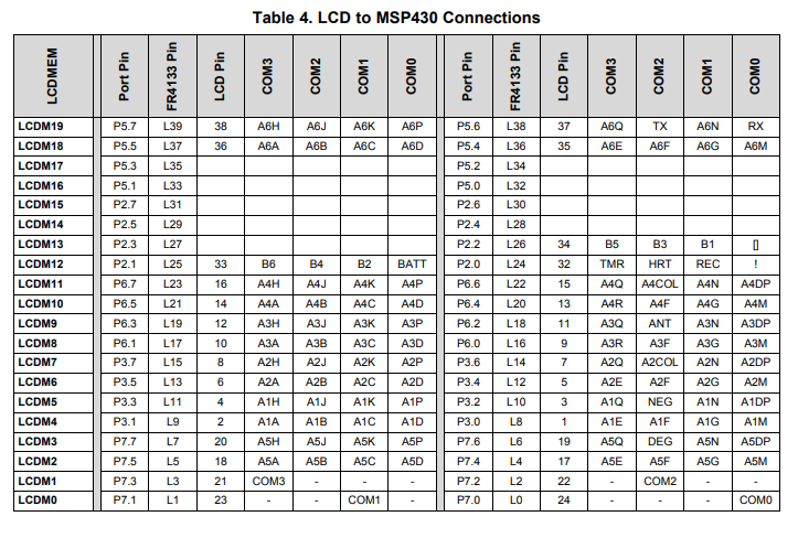

msp430fr4133单片机管脚与LCDMEM之间的对应问题
Other Parts Discussed in Thread: MSP-EXP430FR4133, MSP430FR4133
由于设计线路板的时候没有以为可以后期软件设置脚位对应LCDMEM,
LCDMEM   Port Pin FR4133 Pin LCD Pin COM3 COM2 COM1 COM0   Port Pin FR4133 Pin LCD Pin COM3 COM2 COM1 COM0
LCDM15   P2.7 L31 28 K2P K2C K2B K2A   P2.6 L30 27 K3D K3E K3G K3F
LCDM14   P2.5 L29 26   K3C K3B K3A   P2.4 L28 25 K4D K4E K4G K4F
LCDM13   P2.3 L27 24   K4C K4B K4A   P2.2 L26 23   摄氏度 自动摆风
LCDM12   P2.1 L25 22   W2C W2B W2A   P2.0 L24 21 W2D W2E W2G W2F
LCDM10   P6.5 L21 20   W1C W1B W1A   P6.4 L20 19 W1D W1E W1G W1F
LCDM9   P6.3 L19 18   温度 室温   P6.2 L18 17 定时关机 信号   除湿
LCDM8   P6.1 L17 16   风量1 暖气 冷气   P6.0 L16 15 风量2 风量3 送风 自动
LCDM7   P3.7 L15 14 手动摆风 G1B,G1C KPM 风量自动   P3.6 L14 13 G2D G2E G2G G2F
LCDM6   P3.5 L13 12 G2P G2C G2B G2A   P3.4 L12 11 G3D G3E G3G G3F
LCDM5   P3.3 L11 10 睡眠 G3C G3B G3A   P3.2 L10 9 G4D G4E G4G G4F
LCDM4   P3.1 L9 8   G4C G4B G4A   P3.0 L8 7 GAM   KAM GPM
LCDM2   P7.5 L5 6 定时开机 K1B.K1C 童锁     P7.4 L4 5 K2D K2E K2G K2F
LCDM1   P7.3 L3 4 COM3         P7.2 L2 3   COM2
LCDM0   P7.1 L1 2     COM1     P7.0 L0 1       COM0
导致一个8字不在一个寄存器里面。现在只能改硬件了吗?
