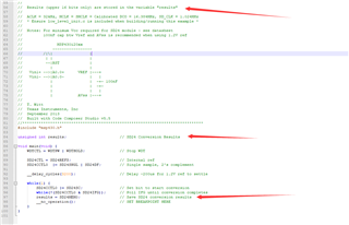

根据数据手册的描述 ADC为24位,但是提供的demo程序接收转换结果是16位的,而且查看ADC的数据寄存器也是16位的
  • 您是可以使用24bit的,但是由于没有24bit的数据,所以您需要使用 32bit的long
    请参考下面的代码

    //  MSP430i20xx Demo - SD24, Continuous Conversion on a Single Channel
    //  Description: This program uses the SD24 module to perform continuous
    //  conversions on a single channel. A SD24 interrupt occurs when a conversion
    //  has completed.
    //  Test by applying voltages to the input channel and setting a breakpoint
    //  at the indicated line. Run program until it reaches the breakpoint, then use
    //  the debugger's watch window to view the conversion results.
    //  Results (upper 16 bits only) are stored in the array "results"
    //  ACLK = 32kHz, MCLK = SMCLK = Calibrated DCO = 16.384MHz, SD_CLK = 1.024MHz
    //  * Ensure low_level_init.c is included when building/running this example *
    //  Notes: For minimum Vcc required for SD24 module - see datasheet

    #include "msp430.h"
    /* Array to store SD24 conversion results */
    volatile int j, index = 0;
    volatile unsigned long sum = 0;
    unsigned long results[100];                     // Final results from running average
    /* Defines */
    #define SW_OVER_SAMPLING_FACTOR                 16
    /* Main Function */
    void main(void) {
        WDTCTL = WDTPW | WDTHOLD;                   // Stop WDT
        SD24CTL = SD24REFS;                         // Internal ref
        SD24INCTL0 = SD24GAIN_1;                    // Set gain on Channel 0
        SD24CCTL0 |= SD24IE;                        // Enable interrupt, OSR = 256 (default)
        __delay_cycles(3200);                       // Delay ~200us for 1.2V ref to settle
        SD24CCTL0 |= SD24SC;                        // Set bit to start conversion
        __bis_SR_register(GIE);                     // Enable interrupts
        while(1) {                                  // Loop endlessly, SET BREAKPOINT or PAUSE HERE
    #if defined(__TI_COMPILER_VERSION__) || defined(__IAR_SYSTEMS_ICC__)
    #pragma vector=SD24_VECTOR
    __interrupt void SD24_ISR(void)
    #elif defined(__GNUC__)
    void __attribute__ ((interrupt(SD24_VECTOR))) SD24_ISR (void)
    #else
    #error Compiler not supported!
    #endif
        long temp = 0;
        switch (__even_in_range(SD24IV,SD24IV_SD24MEM3)) {
            case SD24IV_NONE: break;
            case SD24IV_SD24OVIFG: break;
            case SD24IV_SD24MEM0:
                // Capture ADC data
                SD24CCTL0 &= ~SD24LSBACC;           // Clear LSBACC bit
                temp = SD24MEM0;                    // Read upper 16 bits of SD24MEM0
                SD24CCTL0 |= SD24LSBACC;            // Set LSBACC bit
                temp = temp*256 + (SD24MEM0&0xff);  // Read lower 16 bits of SD24MEM0, combine with upper bits
                // Perform software oversampling
                sum+= temp;                         // Add result to running sum
                j++;
                if(j >= SW_OVER_SAMPLING_FACTOR) {  // Calculate and store average
                    results[index++] = sum/SW_OVER_SAMPLING_FACTOR;
                    sum = 0;
                    j = 0;
                if(index >=100) {
                    index=0;
                break;
