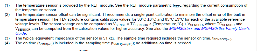

请问MSP430F5438的A10通道ADC的采样误差大概是多少,另外例程在哪里?

    采样误差没有官方说明,这个跟你的参考电压有关。参考电压误差越小,采样误差也越小
  • 我们是采集温度的,温度范围-30~70℃,我看规格书在温度这块写的是误差±3℃,这个也和参考电压有关的吧?
  • 你好,麻烦帮忙确认下规格书这里是误差±3℃吗?还有您说的参考电压误差是哪个参数呢?
  • 你好,这个问题我咨询了一下美国工程师,收到回复如下:
    The ADC accuracy should not be influenced by the temperature calibration. The temperature sensor though could vary based on that calibration, customers can use their own calibration data if they prefer. The ±3 is the range in the calibrations that have been done so a 85℃'s calibration could actually be at 83℃.
