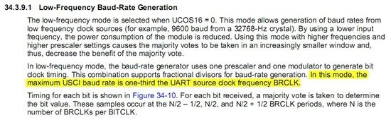

msp430uart串口与电脑通信,430串口时钟选为32.768KHz,波特率为19200,以下寄存器中的值该如何设置?
UCA3CTL1 |= UCSSEL_1;                     // CLK = ACLK
UCA3BR0 = 0x01;                           // 32kHz/19200= 1.7
UCA3BR1 = ?                          //
UCA3MCTL = ?

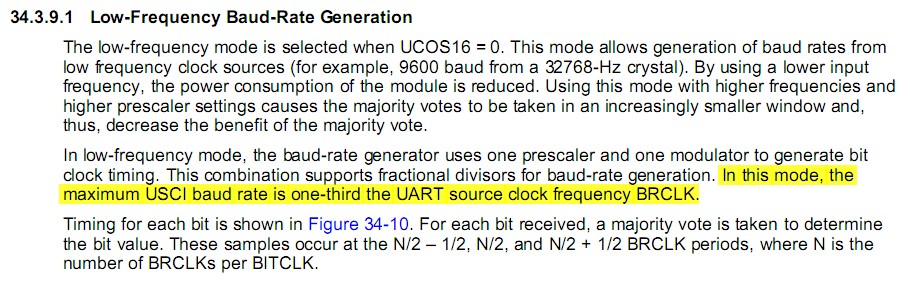

  • 用32768Hz配置19200可能会有问题,实际上32768/3是波特率的最大值,在User Guider中也是在32768下的建议波特率最高到9600.
  • 以下是摘自e2e论坛的回答
    However, 32768/19200 is1.7, so the first bit would be 1/32768s, the next one 2/32768s, then again 1/32768s etc. The resulting bitlenght-error will be far, far beyond any acceptable limit.
    With higher frequencies, the divider gets larger, and the difference between UCBR and UCBR+1 gets smaller, so the maximum bitrate error gets smaller. Or the baudrate can be higher. The maximum baudrate for the USCI is IMHO 1MBd. A faster clock source will not allow higher baudrates, only a higher divider and therefore a smaller error (if it isn't an exact multiple anyway). or allow the 16x overclocking

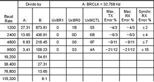

  • 参照下表,32768不能设置19200的波特率,附件中有一个430波特率计算器使用很方便,只要输入频率和波特率就可以计算出来了。
