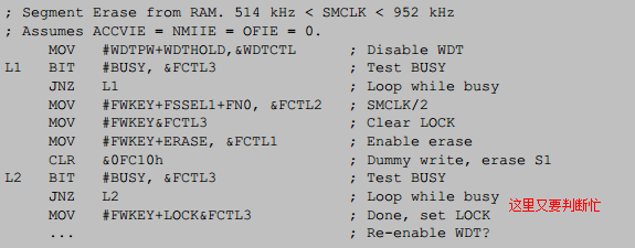

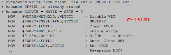

MSP430G2553从RAM里擦除FLASH是什么意思啊,怎么操作的???

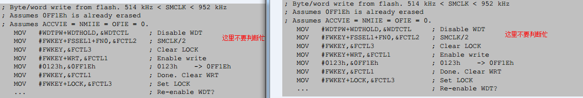

今天看了一天的FLASH,觉得有点奇怪,为什么直接从Flash中擦除不用检测忙标志,而从RAM中要判断,写好像也不要,但块写要判断,这之间有什么差别呢?

    建议参考user guide 中7.3.2 Erasing Flash Memory部分,其中对从FLASH和RAM擦除FLASH进行了详细的讲解。下列是参考x2xx user guide
    1. 从FLASH擦除不需检测BUSY位是因为:
    When a flash segment erase operation is initiated from within flash memory, all timing is controlled by the flash controller, and the CPU is held while the erase cycle completes.
    2. 从RAM要判断是因为:
    Any erase cycle may be initiated from RAM. In this case, the CPU is not held and can continue to execute
    code from RAM. The BUSY bit must be polled to determine the end of the erase cycle before the CPU
    can access any flash address again. If a flash access occurs while BUSY = 1, it is an access violation,
    ACCVIFG will be set, and the erase results will be unpredictable.
    3. 从FLASH Byte/Word写不需要判断,但是从RAM中的Byte/Word写也是需要判断的:
    When a byte/word write is executed from RAM, the CPU continues to execute code from RAM. The BUSY
    bit must be zero before the CPU accesses flash again, otherwise an access violation occurs, ACCVIFG is
    set, and the write result is unpredictable
    4. 块写只能从RAM发起,而不能从FLASH发起
    A block write cannot be initiated from within flash memory. The block write must be initiated from RAM
    only. The BUSY bit remains set throughout the duration of the block write. The WAIT bit must be checked
    between writing each byte or word in the block. When WAIT is set the next byte or word of the block can
    be written.

    其实这些我都有看到过,不过英文不太好,看英文文档比较费劲,很多都没看太明白就跳过去了。谢谢你帮我的归纳
    可是我还是分不开什么时候是FLASH 写或擦除,什么时候是从RAM开始写或擦除。。看它的例程,好像从RAM和从FLASH是一样的
    下面是我 昨天写的一个例程,是参照别人的写的,工作是可以工作,不过我还是分不清细节方面的东西,可以再麻烦你给我讲下
    他们的差别吗,或者发个例程给我参考下 谢谢

  • shuai lee,
    其实你就是想知道从RAM和FLASH进行FLASH操作的区别是什么,其实这个就是进行FLASH操作的这段代码是运行在哪里,如果是运行在RAM里,那就叫从RAM发起的FLASH操作,如果运行在FLASH里,那就叫从FLASH发起的FLASH操作。其实从RAM发起,就是指把程序复制到RAM区,然后对FLASH操作。
    若是从FLASH发起的,那么就不能对代码所在的FLASH区域进行操作,而若是从RAM发起的,那就可以对任何FLASH区域进行操作。即从 RAM 发起的 Flash 擦除或写操作,可以对整个 Flash 区域进行擦除或写操作,而从 Flash 区域发起的 Flash 擦除或写操作,就不能对当前程序所处的段进行擦除或写操作。
    另外,你可以看看数据手册,上面也写到代码在RAM里执行和从FLASH中执行,在ACtive状态时,功耗其实是不一样的。那里的从RAM执行,就是将代码复制到RAM区,然后执行的。
    希望对你有帮助!O(∩_∩)O~
  • 嗯,谢谢了!就是这个搞不明白,现在有点明白了,我想我们应该一般用的都是从FLASH开始的吧,
    那个把代码复制放到RAM应该一般都不会这样去做 。
