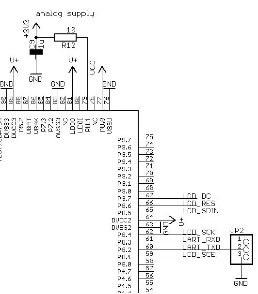

各位先進大家好:
初涉MSP430系列,有許多地方看到datasheet仍然是懵懵懂懂,請各位見諒!
【芯片型号】MSP430F5338
【CCS版本】Code Composer Studio Version: 6.1.0.00104
【问题描述】我的開發板電源是參考以下圖去設計的
我遇到的問題是,當我要初始化讓第77隻腳(也是供給LCD的Vcc電源),讓第77隻腳未能輸出3V,我該如何設定呢?我初始化以下的Code,怎麼設都只有輸出2.5V
是否有哪個環節出錯,還請各位先進指教,謝謝!

void sys_init(void)
PMMCTL0_H = PMMPW_H; /* Open PMM Registers for write and set */
// Disable the GPIO power-on default high-impedance mode to activate
// previously configured port settings
PM5CTL0 &= ~LOCKLPM5 ; //PM5CTL0 = 0x00; /* reset LPM5LOCK bit (解鎖IO)*/
/* initialize all ports to reduce power consumption */
P4DIR = 0xff;
P4OUT = 0;
P3DIR = 0xff;
P3OUT = 0;
P2DIR = 0xff;
P2OUT = 0;
P1DIR = 0xfc;
P1OUT = 0x03;
P9DIR = 0xff;
P9OUT = 0;
P5DIR |= 0xfe;
P5OUT = 0;
P7DIR = 0xff;
P7OUT = 0;
/* enable port u output (used to switch power on the system) */
// Configure PU.0 as output pins
LDOKEYPID = 0x9628; /* Enable access to config registers,unlock LDO module */
//PUCTL = (1 << 5); /* enable, PU.0 and PU.1 are low*/
PUCTL |= PUOPE + PUOUT1; // PortU input enable
// PU.0 = low and PU.1 = high
LDOKEYPID = 0x0000; /* // Disbale access to config registers ,lock LDO module */

void sys_extpower_switch(bool pwrOn)
LDOKEYPID = 0x9628; /* unlock LDO module */
if (pwrOn)
PUCTL |= (1 << 1) | (1 << 0);
else
PUCTL &= ~(1 << 5);
PUCTL &= ~((1 << 1) | (1 << 0));
//LDOPWRCTL = 0x0000;
LDOKEYPID = 0x0000; /* lock LDO module */
