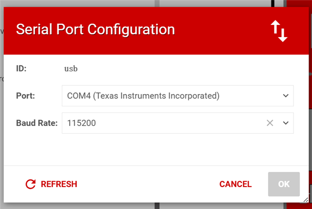

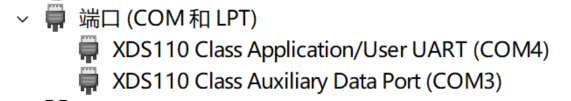

Part Number: LP-MSPM0G3507
Computer already detedcted port
Already set the option as request.
But still unable to connect the device
However, I could use keil to download programme into device
您好,
Error -260 0x0 对应报错提示是 Error initializing Emulator吧,
XDS110没有初始化成功,大概率和USB供电能力有关。
建议换个USB口试一下,另外也可使用外部电源单独给板子供电。
