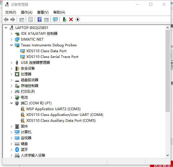

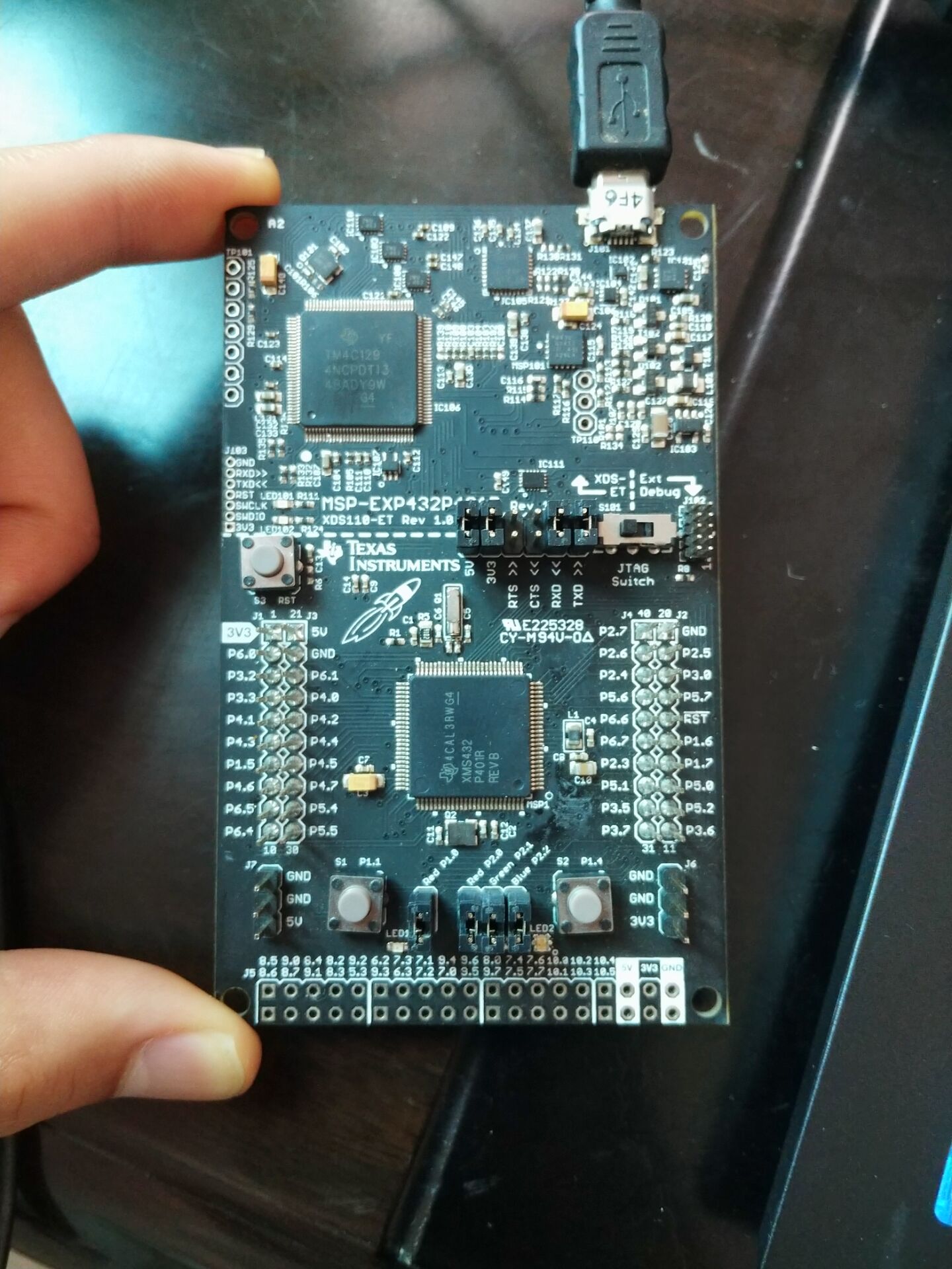

MSP432P401R黑板出现设备驱动无法启动代码10, 如何解决设备驱动出现黄色现感叹号,一直没找到解决办法,求解答
 我用的是win10企业版,下载了CCS10
下载之后,未在设备设备管理器中出现关于TI的驱动设备
于是根据网上步骤自己手动添加了设备驱动
但是出现如下图的问题(已经重装软件很多遍了,用虚拟机也是出现这种情况)
请问前辈们如何解决这种问题

    请问您是如何手动添加驱动的?
    您可以不需要手动更新的,安装了CCS之后,插上板子是可以自动安装驱动的
  • 在我下载CCS软件后,我插入后板子电脑并没有任何反应,当我用CCS下载程序也显示没有连接目标板
    .添加驱动,是在win10中的设备管理器中
    点击了操作选项里的添加过时设备里添加的

    您可以尝试如下操作,若是您安装了CCS的话
    1 设备管理器内右键点击端口
    2 选择update driver
    3 按照下图路径(即CCS内的驱动)更新一下
    我尝试右键disable了我的小红板,而后手动更新驱动并右键enable该端口,可以正常识别的

    I had a problem with the same symptoms and was able to resolve it. I don't guarantee that it will solve your problem.
    My problem stems from:
    1. The debug interface XDS110 with CMIS-DAP needs WinUSB
    2. WinUSB is installed on Windows Vista and all subsequent versions of Windows, but not Windows XP
    This is usually handled in Windows XP with a co-installer.
    TI already has some files which look like they should co-install WinUSB, so I don't know what went wrong.
    I was able to resolve it manually by using a program called zadig from http://zadig.akeo.ie/
    The procedure I followed was:
    1. Read the instructions on the web site. Read the usage guide.
    2. Download the zadig program for Windows XP and run it. Do not download the program for Vista or later.
    3. The program won't show you anything to change until you plug in the Launchpad
    4. In the selection box of the program, choose XDS110 with CMIS-DAP (the first interface);
    5. In the selection box of the program, choose XDS110 with CMIS-DAP (the second interface)
    6. Exit the program
    The device manager should say that both devices now have drivers.
    Windows may want to re-install the driver if you plug the Launchpad into a different USB port.
    The location for the driver on my installation is C:ti/ccsv6/ccs_base/emulation/windows/xds110_drivers/
