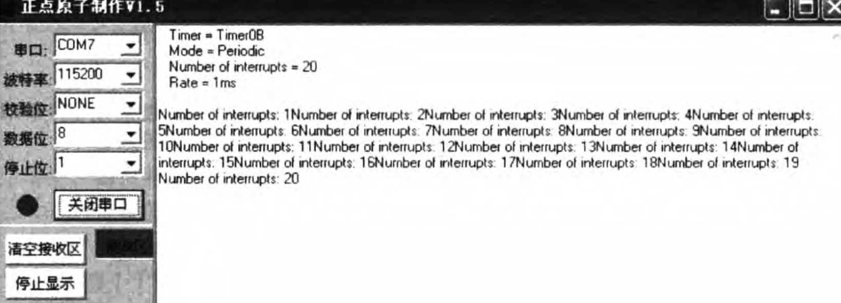

使用timmer的定时器无法进入第二次中断程序
本人在编写用定时器控制单片机中断20次的实验中,发现无法进入第二次中断,进入第一次中断后就一直在while循环,也清除了标志位,麻烦大神帮看一下

#define NUMBER_OF_INTS 20
static volatile uint32_t g_ui32Counter = 0;

        SysCtlPeripheralEnable(SYSCTL_PERIPH_TIMER0);
        TimerConfigure(TIMER0_BASE, TIMER_CFG_SPLIT_PAIR | TIMER_CFG_PERIODIC);
        TimerLoadSet(TIMER0_BASE, TIMER_B, SysCtlClockGet()/50);
        IntEnable(INT_TIMER0B);
        TimerIntEnable(TIMER0_BASE, TIMER_TIMB_TIMEOUT);
        IntMasterEnable();
        TimerIntRegister(TIMER0_BASE, TIMER_B, Timer0IntHandler);
        g_ui32Counter = 0;
        TimerEnable(TIMER0_BASE, TIMER_B);
        while(1){
       if(ui32PrevCount != g_ui32Counter)
          UARTprintf("Number of interrupts : %d\r",g_ui32Counter);
          ui32PrevCount = g_ui32Counter;
          ROM_GPIOPinWrite(GPIO_PORTN_BASE, GPIO_PIN_0, GPIO_PIN_0);
void Timer0IntHandler(void)
    // Clear the timer interrupt.
    TimerIntClear(TIMER0_BASE, TIMER_TIMB_TIMEOUT);
    g_ui32Counter++;
    /*if(g_ui32Counter == NUMBER_OF_INTS)
        // Read the current state of the GPIO pin and
        // write back the opposite state
    IntDisable(INT_TIMER0B);
    TimerIntDisable(TIMER0_BASE, TIMER_TIMB_TIMEOUT);
                ROM_GPIOPinWrite(GPIO_PORTN_BASE, GPIO_PIN_0, 0);
  • 我会在测试后给您回复
  • 谢谢!这是整个工程文件timers.zip
  • 目前我手边只有TM4C123的板子,所以是用TM4C123测试的
    没有直接测试您的工程,而是只是测试了timerB的功能。请您对照下面的代码来进行修改
    代码和测试结果如下:
    代码的话,需要注意添加Timer0BIntHandler
    // periodic_16bit.c - Example demonstrating a periodic 16-bit timer.

    //! - INT_TIMER0B - Timer0BIntHandler
    // Number of interrupts before the timer gets turned off.
    #define NUMBER_OF_INTS          1000
    // Counter to count the number of interrupts that have been called.

    // The interrupt handler for the Timer0B interrupt.
    void
    Timer0BIntHandler(void)
        // Clear the timer interrupt flag.
        // Update the periodic interrupt counter.
        g_ui32Counter++;
        // Once NUMBER_OF_INTS interrupts have been received, turn off the
        // TIMER0B interrupt.
            // Disable the Timer0B interrupt.
            // Turn off Timer0B interrupt.
            // Clear any pending interrupt flag.

    不过修改过后我的程序还是停留在Number of interrupts : 1这里
    另外不应该是每中断一次printf一次吗就像图片里这样,我的文件就是根据这个教程编写的,也不知哪里出错了,第二次中断还是进不去

  • 好的,不过为什么printf的不是每中断一次printf中断编号呢
  • 您可以修改串口显示语句,这样就可以换行显示了
       UARTprintf("\n   Number of interrupts: %d\r", g_ui32Counter);
  • 您好,我的意思不是要换行显示,而是程序应该像图片里一样printf每次中断的序号
  • 之前也是可以显示,但是没有换行,所以持续刷新第一行,下面是添加换行后的显示。
