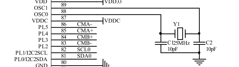

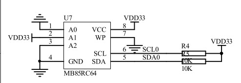

TM4C129的i2c有bug吗?
void I2CInit(void)
  MAP_SysCtlPeripheralEnable(SYSCTL_PERIPH_I2C2);
  MAP_GPIOPinConfigure(GPIO_PL0_I2C2SDA);
  MAP_GPIOPinTypeI2C(GPIO_PORTL_BASE, GPIO_PIN_0);
  MAP_GPIOPinConfigure(GPIO_PL1_I2C2SCL);
  MAP_GPIOPinTypeI2CSCL(GPIO_PORTL_BASE, GPIO_PIN_1);
  I2CMasterInitExpClk(I2C2_BASE, 120000000, 1);
  I2CMasterEnable(I2C2_BASE);

读写铁电单步调试FM24CL64Write和FM24CL64Read就可以正常读写,全速就不正确,后来经过各种调试发现在WaitI2CFinished函数里面加 SysCtlDelay(10);的延时就正常了,这到底是什么原因啊?是否存在这种bug?
