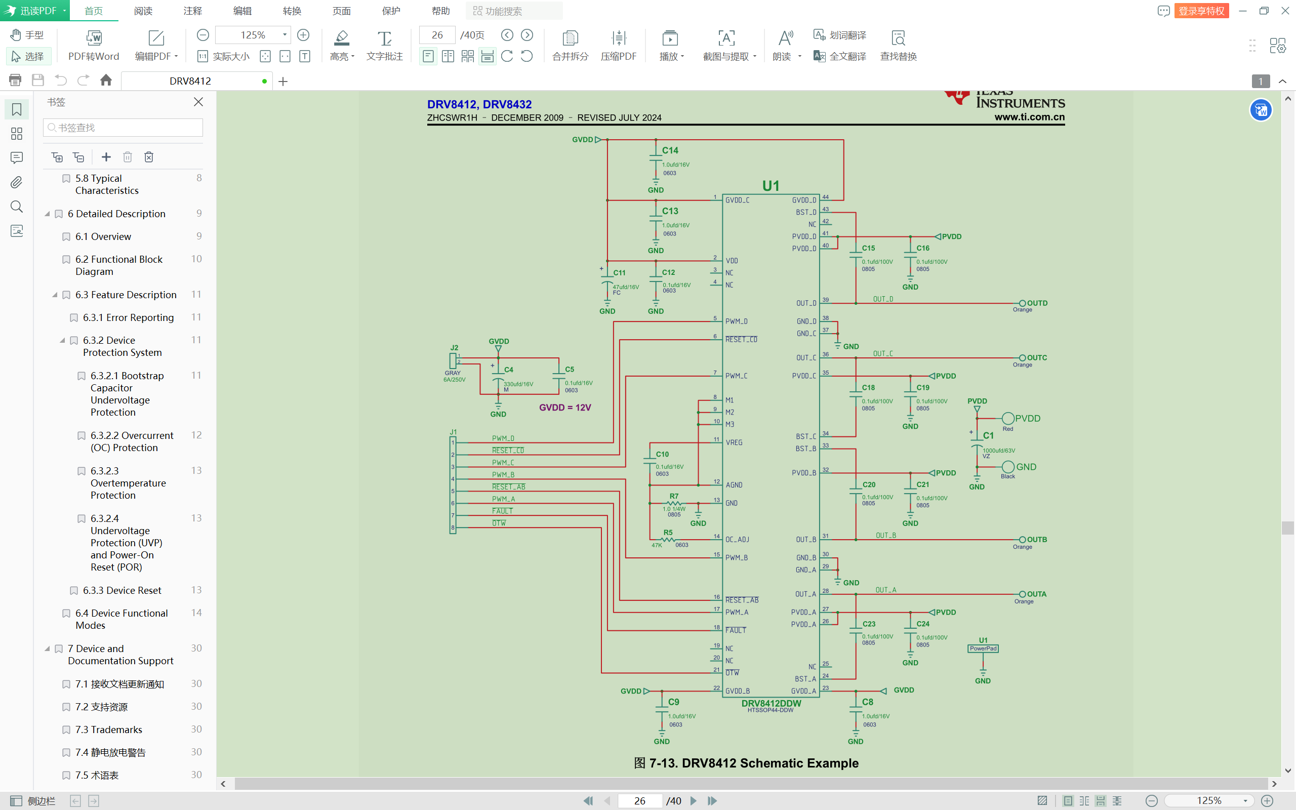

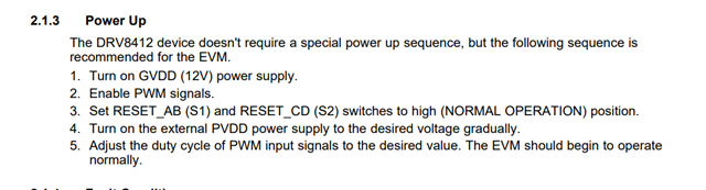

DRV8412: Regardless of the power up/down sequence,will the one that powers on first charge the one that powers on later between GVDD/VDD and PVDD ?
Part Number: DRV8412
