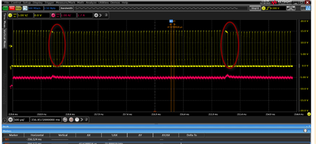

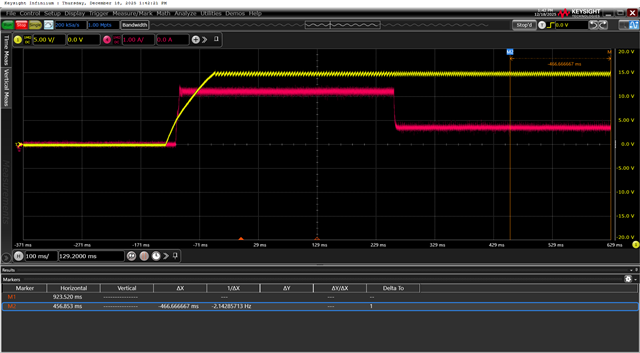

Hi team,

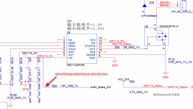

when I use  DRV110   drive   the  Electromagnetic brake,   I found  if  my  pwer supply  is 48V,  then  the VIN  is going to be 15V, because  of the function  of  15V zener  diode  inside,  but  the OUT pin  PWM  frequency    became unstable, and the   Electromagnetic brake make a audible noise.
  when I  add  a  12V   zener  diode at the VIN pin, let  the 15V zener  diode  does not  work,    the
 issue is  solved.
Does  the  15V zener  work   cause  this  issue?
